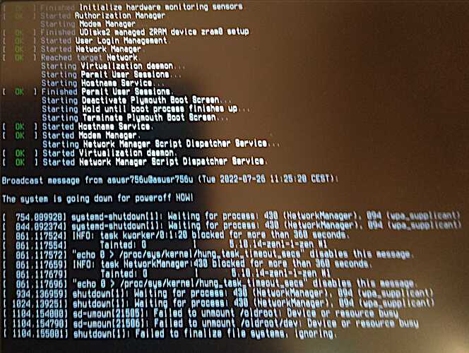

O dear, system failed to shutdown. Had to use the laptop button (see picture). At reboot, Octopi freezes while trying to install Gimp, could even not send this message from Firedragon which "is already running" but doesn't display its window.
Linuxian for more than 10 years, maybe I'm a bad Garuda user. I am so sorry...

It is never good to press the power button (hard reset).
There is still the way via TTY or “REISUB”.
Your laptop doesn’t seem to be the strongest, are you sure it was frozen?

This “guy” leaved the session using the power off button. Then, pressed the “escape” button to see the shutting down process log at 11h00 PM, hardly reset after I got home at 19h00 AM , screen still showing the messages of the picture above. What else could I do?
