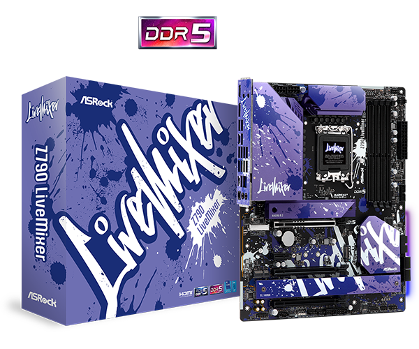

Type: Desktop Mobo: ASRock model: Z790 LiveMixer
Megatrends LLC. v: 3.09 date: 10/07/2022
UEFI: American Megatrends LLC. v: 3.09 date: 10/07/2022
First pls Bios Update → after this think on the relevant bios settings (scb= off, fb=off, ahci, uefi)
And ?
I updated BIOS to version 21.02, settings are set (and were before update) as you suggested.
