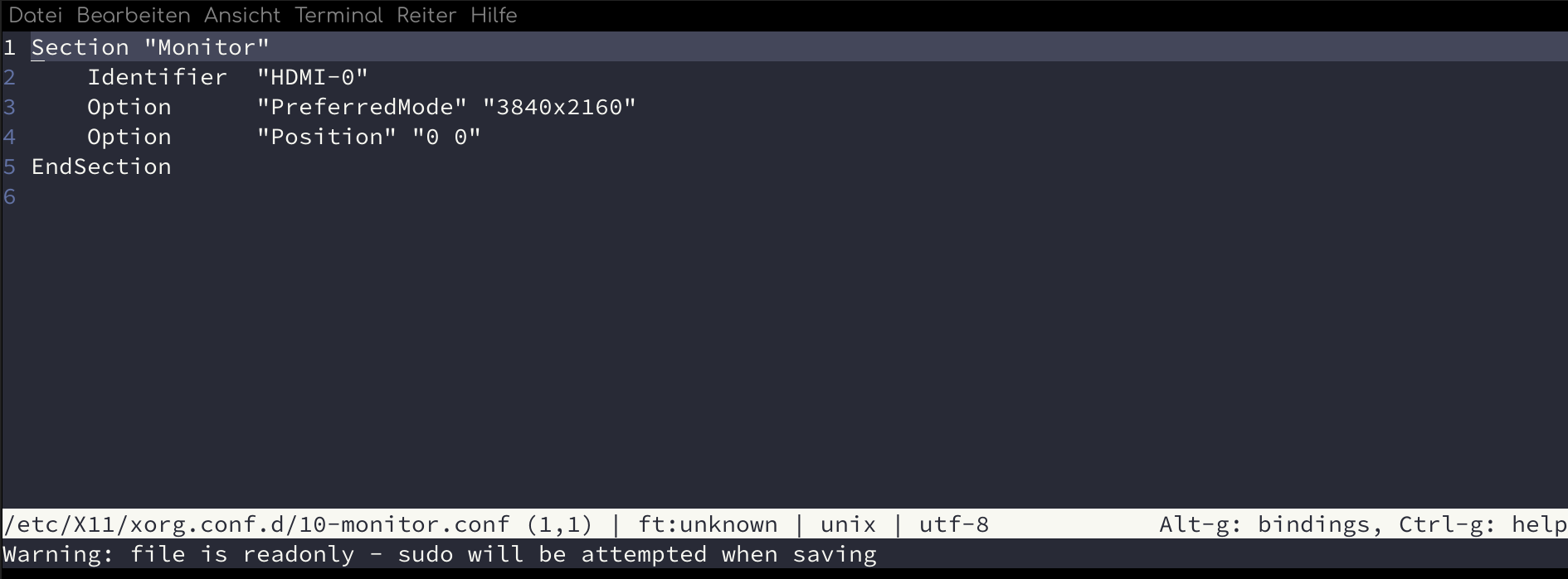

Some explanations for future readers and possibly OP better application of the solution.
- Screen resolution is correct (two monitors side by side)
- Notice the actual recognized-as monitor dimensions!!
- While Mon-2 looks fine (48cm x 27cm - 21"), Mon-1 looks like a large⦠smartphone
(16cm x 9 cm - 7"). I guess itās not true(??)
These are not rare issues with Xorg <==> EDID misunderstandings. - SDDM is probably set to use auto-HiDPI scaling.
- Xorg thinks/serves Mon-1 as HiDPI and SDDM⦠believes him!
There are two possible approaches, that one or both could work, but sometimes are difficult to configure. Use the easiest successful one.
- Fix/correct Xorg monitor-1 resolution/dpi/modeline, using an xorg conf file in
/etc/X11/xorg.conf.d/monitor-dp-1.confwith a properSection Monitor. - Fix SDDM configuration, changing HiDPI to disabled
[X11]
EnableHiDPI=false
and/or
- adding a working dpi value at Xorg server flags (as was successfully advised by @FGD )
ā¦but⦠using the proper/suggested drop-in file in
/etc/sddm.conf.d/hidpi.conf
and deleting /etc/sddm.conf, which is deprecated and used as fallback (overrides all drop-in settings).
Once again, always check Archwiki for proper guidance, instead of random (years old
) forum/web advice.
Keep up the good work @FGD ![]()
There is absolutely nothing ![]()
Of course not. If you choose this method, you would create it, with proper contents, following Archwiki instructions.
As I saidā¦
