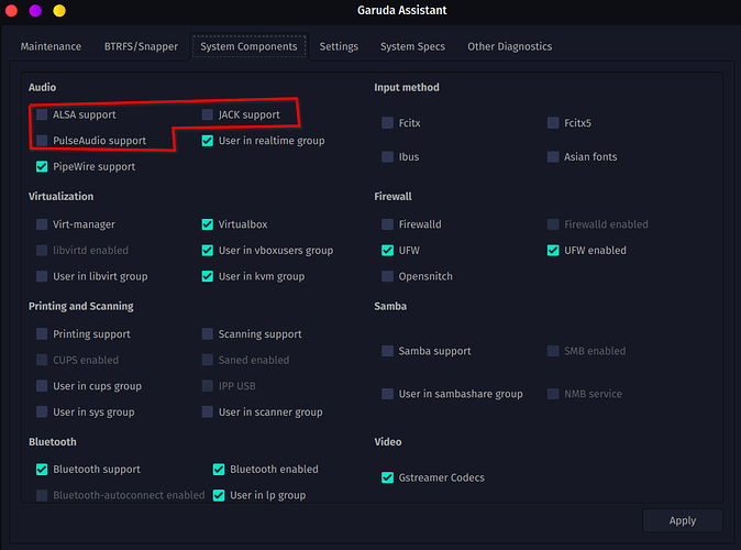

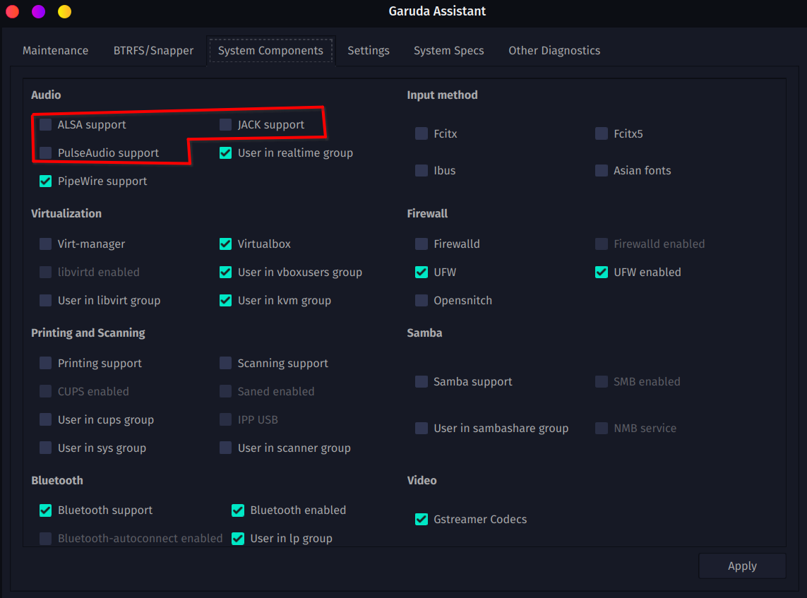

If nothing at all works how about trying out pulseaudio and see if the issue persists with that as well? Though I must inform you would have to remove pipewire for this to work. Having multiple sound servers can cause issues like audio crackling/tearing etc.
To perform the switch open garuda assistantsystem components
and tick :white_check_mark: ALSA support, JACK support, PulseAudio support while
untick Pipewire support
