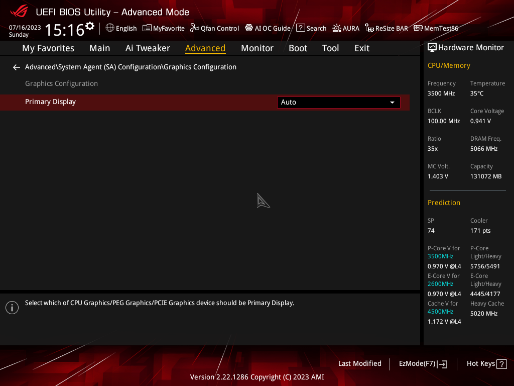

Actually there’s an option in UEFI about iGPU but it doesn’t really seem to disable it. Check this, it looks quite similar to what I have in bios.

Switching off the iGPU (which is possible on some laptops) was only intended for troubleshooting.
