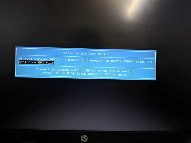

Hello guys, so after a long time i have recently installed garuda in my new laptop dual boot with windows 11.
And I already know that sometimes windows boot manager replaces grub in boot order.
And i used to fix it by going in BIOS and putting garuda on top of boot order(in my old laptop)
But in this new laptop in which i installed garuda, windows again replaced grub but now i cant find garuda in boot menu entry, however i can still boot it by choosing to boot using efi file and inside garuda folder and then choosing grubx64.efi
So i want grub back in boot menu entry. So i checked efibootmgr but garuda was missing from that as well.
So i ran update-grub and then garuda-boot-repair and chose repair option. I did not chose reinstall grub as i dont know what to choose further MBR, root and choose which partition.
Here is my garuda-inxi

here is efibootmgr
λ sudo efibootmgr
Timeout: 0 seconds
BootOrder: 0000,9999
Boot0000* Windows Boot Manager
Boot9999* USB Drive (UEFI)

Also posting screenshot of bootscreen
And while using garuda-boot-repair and choosing reinstall grub. I dont know which option to choose
Ss below
Can anyone tell what to do?
