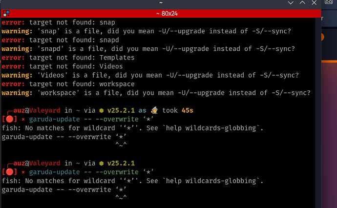

Greetings,
I have run into a bit of a conundrum with updating my system. I have gone through the forums, found a few –overwrite posts and other tactics that pertain to thunderbird only, and none work in my favour … so I am reaching out to the masses to see if you all can help me stifle this problem. And a few may ask, why not ask ChatGPT for help? Well, I prefer human experience and not machine learned when it comes to my files. :slight_smile: Here’s the issue:
(661/661) checking keys in keyring                 [----------------------] 100%
(661/661) checking package integrity               [----------------------] 100%
(661/661) loading package files                    [----------------------] 100%
(661/661) checking for file conflicts              [----------------------] 100%
error: failed to commit transaction (conflicting files)
python-pyudev: /usr/lib/python3.13/site-packages/pyudev-0.24.3.dist-info/COPYING exists in filesystem
python-pyudev: /usr/lib/python3.13/site-packages/pyudev-0.24.3.dist-info/METADATA exists in filesystem
python-pyudev: /usr/lib/python3.13/site-packages/pyudev-0.24.3.dist-info/RECORD exists in filesystem
python-pyudev: /usr/lib/python3.13/site-packages/pyudev-0.24.3.dist-info/WHEEL exists in filesystem
python-pyudev: /usr/lib/python3.13/site-packages/pyudev-0.24.3.dist-info/top_level.txt exists in filesystem
python-pyudev: /usr/lib/python3.13/site-packages/pyudev/__init__.py exists in filesystem
python-pyudev: /usr/lib/python3.13/site-packages/pyudev/__pycache__/__init__.cpython-313.pyc exists in filesystem
python-pyudev: /usr/lib/python3.13/site-packages/pyudev/__pycache__/_errors.cpython-313.pyc exists in filesystem
python-pyudev: /usr/lib/python3.13/site-packages/pyudev/__pycache__/_qt_base.cpython-313.pyc exists in filesystem
python-pyudev: /usr/lib/python3.13/site-packages/pyudev/__pycache__/_util.cpython-313.pyc exists in filesystem
python-pyudev: /usr/lib/python3.13/site-packages/pyudev/__pycache__/core.cpython-313.pyc exists in filesystem
python-pyudev: /usr/lib/python3.13/site-packages/pyudev/__pycache__/discover.cpython-313.pyc exists in filesystem
python-pyudev: /usr/lib/python3.13/site-packages/pyudev/__pycache__/glib.cpython-313.pyc exists in filesystem
python-pyudev: /usr/lib/python3.13/site-packages/pyudev/__pycache__/monitor.cpython-313.pyc exists in filesystem
python-pyudev: /usr/lib/python3.13/site-packages/pyudev/__pycache__/pyqt4.cpython-313.pyc exists in filesystem
python-pyudev: /usr/lib/python3.13/site-packages/pyudev/__pycache__/pyqt5.cpython-313.pyc exists in filesystem
python-pyudev: /usr/lib/python3.13/site-packages/pyudev/__pycache__/pyside.cpython-313.pyc exists in filesystem
python-pyudev: /usr/lib/python3.13/site-packages/pyudev/__pycache__/pyside6.cpython-313.pyc exists in filesystem
python-pyudev: /usr/lib/python3.13/site-packages/pyudev/__pycache__/version.cpython-313.pyc exists in filesystem
python-pyudev: /usr/lib/python3.13/site-packages/pyudev/__pycache__/wx.cpython-313.pyc exists in filesystem
python-pyudev: /usr/lib/python3.13/site-packages/pyudev/_ctypeslib/__init__.py exists in filesystem
python-pyudev: /usr/lib/python3.13/site-packages/pyudev/_ctypeslib/__pycache__/__init__.cpython-313.pyc exists in filesystem
python-pyudev: /usr/lib/python3.13/site-packages/pyudev/_ctypeslib/__pycache__/_errorcheckers.cpython-313.pyc exists in filesystem
python-pyudev: /usr/lib/python3.13/site-packages/pyudev/_ctypeslib/__pycache__/libc.cpython-313.pyc exists in filesystem
python-pyudev: /usr/lib/python3.13/site-packages/pyudev/_ctypeslib/__pycache__/libudev.cpython-313.pyc exists in filesystem
python-pyudev: /usr/lib/python3.13/site-packages/pyudev/_ctypeslib/__pycache__/utils.cpython-313.pyc exists in filesystem
python-pyudev: /usr/lib/python3.13/site-packages/pyudev/_ctypeslib/_errorcheckers.py exists in filesystem
python-pyudev: /usr/lib/python3.13/site-packages/pyudev/_ctypeslib/libc.py exists in filesystem
python-pyudev: /usr/lib/python3.13/site-packages/pyudev/_ctypeslib/libudev.py exists in filesystem
python-pyudev: /usr/lib/python3.13/site-packages/pyudev/_ctypeslib/utils.py exists in filesystem
python-pyudev: /usr/lib/python3.13/site-packages/pyudev/_errors.py exists in filesystem
python-pyudev: /usr/lib/python3.13/site-packages/pyudev/_os/__init__.py exists in filesystem
python-pyudev: /usr/lib/python3.13/site-packages/pyudev/_os/__pycache__/__init__.cpython-313.pyc exists in filesystem
python-pyudev: /usr/lib/python3.13/site-packages/pyudev/_os/__pycache__/pipe.cpython-313.pyc exists in filesystem
python-pyudev: /usr/lib/python3.13/site-packages/pyudev/_os/__pycache__/poll.cpython-313.pyc exists in filesystem
python-pyudev: /usr/lib/python3.13/site-packages/pyudev/_os/pipe.py exists in filesystem
python-pyudev: /usr/lib/python3.13/site-packages/pyudev/_os/poll.py exists in filesystem
python-pyudev: /usr/lib/python3.13/site-packages/pyudev/_qt_base.py exists in filesystem
python-pyudev: /usr/lib/python3.13/site-packages/pyudev/_util.py exists in filesystem
python-pyudev: /usr/lib/python3.13/site-packages/pyudev/core.py exists in filesystem
python-pyudev: /usr/lib/python3.13/site-packages/pyudev/device/__init__.py exists in filesystem
python-pyudev: /usr/lib/python3.13/site-packages/pyudev/device/__pycache__/__init__.cpython-313.pyc exists in filesystem
python-pyudev: /usr/lib/python3.13/site-packages/pyudev/device/__pycache__/_device.cpython-313.pyc exists in filesystem
python-pyudev: /usr/lib/python3.13/site-packages/pyudev/device/_device.py exists in filesystem
python-pyudev: /usr/lib/python3.13/site-packages/pyudev/discover.py exists in filesystem
python-pyudev: /usr/lib/python3.13/site-packages/pyudev/glib.py exists in filesystem
python-pyudev: /usr/lib/python3.13/site-packages/pyudev/monitor.py exists in filesystem
python-pyudev: /usr/lib/python3.13/site-packages/pyudev/pyqt4.py exists in filesystem
python-pyudev: /usr/lib/python3.13/site-packages/pyudev/pyqt5.py exists in filesystem
python-pyudev: /usr/lib/python3.13/site-packages/pyudev/pyside.py exists in filesystem
python-pyudev: /usr/lib/python3.13/site-packages/pyudev/pyside6.py exists in filesystem

╭─auz@Valeyard in ~ via  v25.2.1 as :mage: took 45s
[:red_circle:] × garuda-update – --overwrite ‘
fish: No matches for wildcard '‘
’'. See help wildcards-globbing.
garuda-update – --overwrite ‘*’
Please do not post pictures from the terminal. Terminal output always belongs in a code block. Thanks.
Open the KDE konsole, copy the command:
garuda-update -- --overwrite '*'
paste it into the konsole with Ctrl + Shift + V and press Enter.
Oh for crying out loud … you’re telling me terminal futzed up and that’s all I needed? Thanks @nepti … that worked!
Seems like you copypasta’d typographer’s quotation marks instead of the vanilla ones.
Something has indeed gone wrong:
Funnily enough, the command in my clipboard is correct, but after pasting it into my first post and then sending it, it is not. :thinking:
I tested the exact same content from the clipboard in my konsole and then used it in my last post, and it’s correct there:
Looks like something went wrong when posting, so I’m blaming Discourse. :person_shrugging: :upside_down_face:
