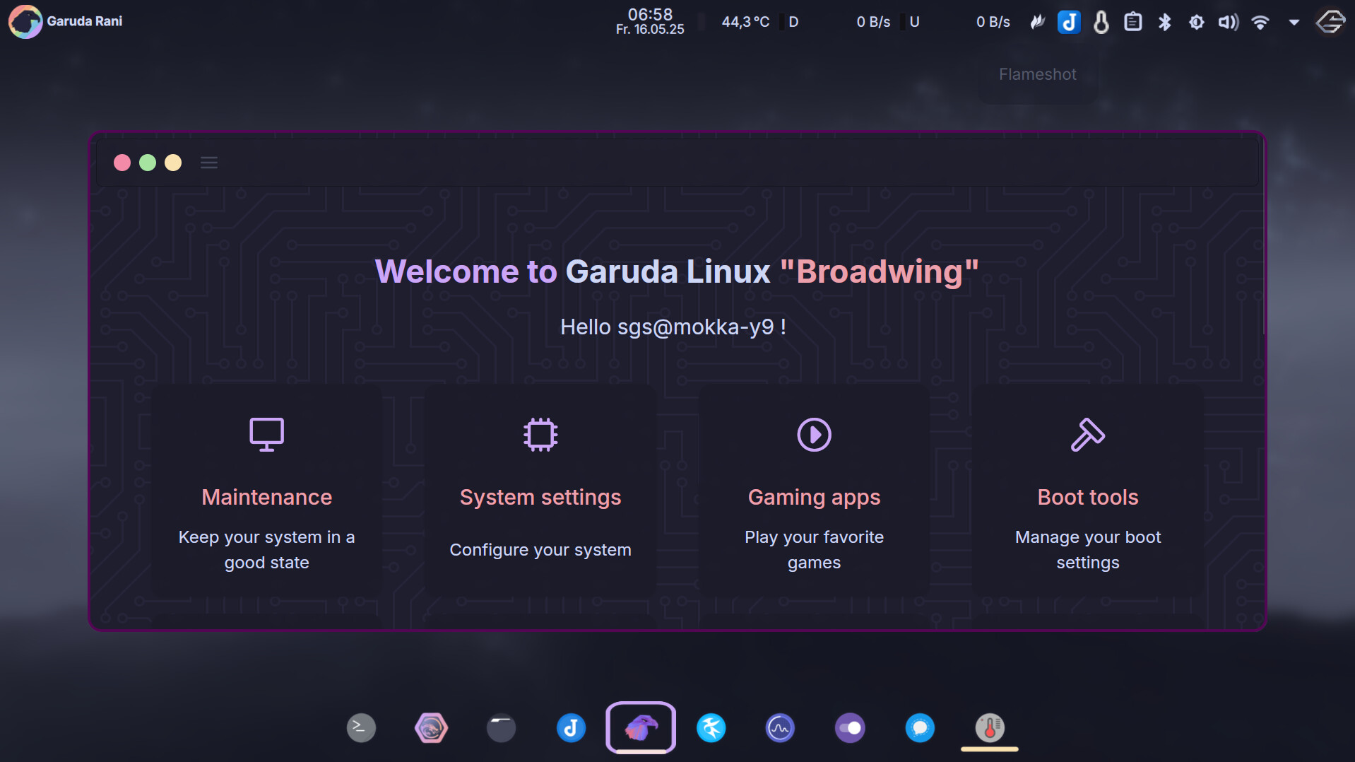

After some trial and error, I was able to create the data for a centered display for this notebook :slight_smile: . The .config/org.garudalinux.rani/.window-state.json is not generated when RANI is opened for the first time.
No problem, but I wanted to have it out of curiosity. :grin:
  "main": {
    "width": 1670,
    "height": 710,
    "x": 125,
    "y": 185,
    "prev_x": 125,
    "prev_y": 185,
    "maximized": false,
    "visible": true,
    "decorated": false,
    "fullscreen": false
