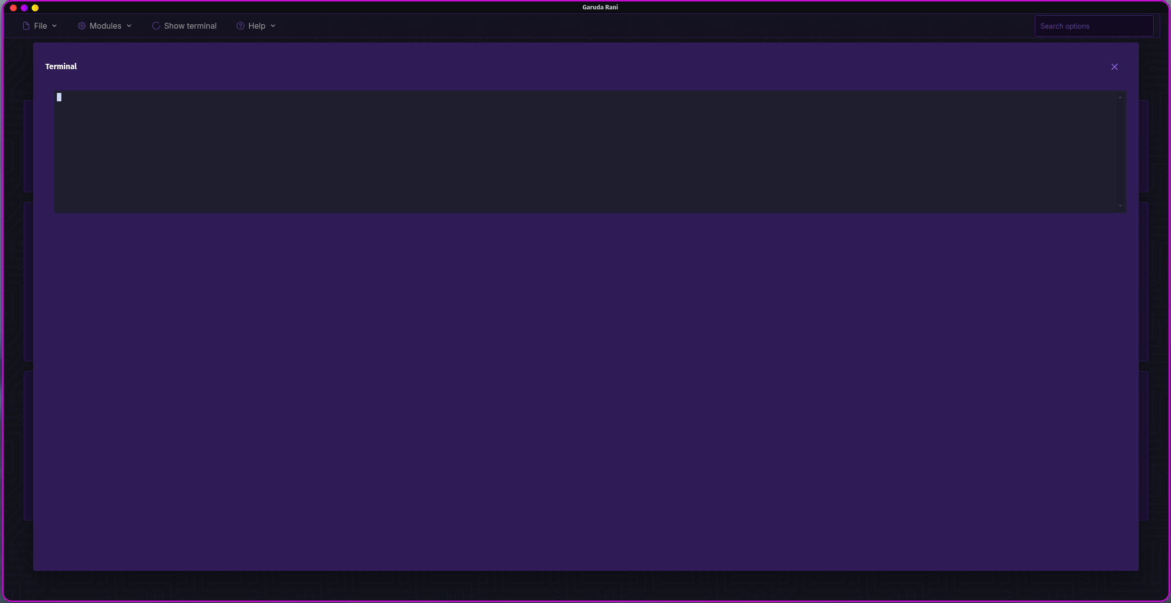

Regarding the new garuda-rani application, I wanted to report an issue I’m seeing with the 3.1.4-3 version which is currently installed. Whenever I take an action that invokes the terminal, the terminal output does not extend to the full size of the window that opens.
This does not appear to be related to the Garuda Rani window size topic, so I figured I would report it since when I first installed Rani the terminal did extend to the full window size.
I took a screenshot to show what I’m referring to, but I think my account is too new to allow me to add it to this topic. Please let me know how best to share this in case it’s not clear what I’m referring to.

I’m having the same issue for a while now, just scrolls in a small area at the top of the window, winds me up trying to fathom what could cause it and what might fix it.

I’d assume this is yet another primeng component change. I think I’ve just fixed that.

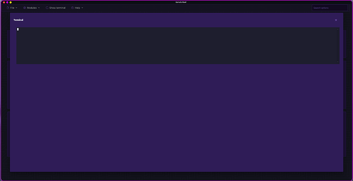

Fully updated as of the time of this post, terminal window still broken if the fix you made is live.
Are you using the git version? I’ve not pushed to stable yet.
3.1.4.r5.gc545263-1
Im current with garuda-update only, I haven’t gone looking for bleeding edge fixes directly, which is why I figured it may not be on live when nothing changed.
garuda-rani 3.1.4-3
