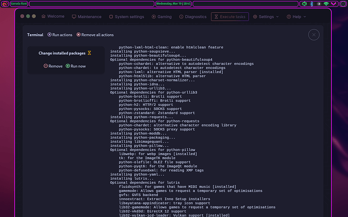

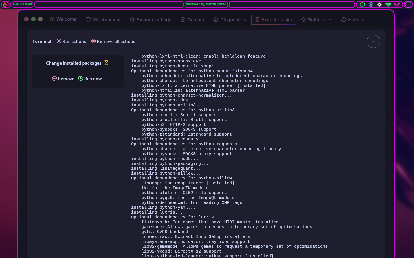

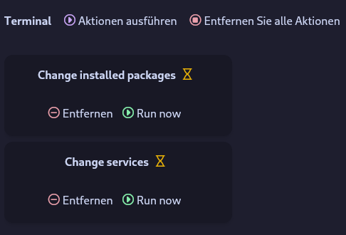

I activate the required checkboxes
→ switch to rani terminal
the tasks run…
log from rani tell me
2025-03-19][12:05:26][INFO][webview:info@tauri://localhost/main-3TDGM4QU.js:30763:16] Executing task: pacman --noconfirm -S scanning-support
[2025-03-19][12:05:31][INFO][webview:info@tauri://localhost/main-3TDGM4QU.js:30763:16] Task has finished.
[2025-03-19][12:05:55][INFO][webview:info@tauri://localhost/main-3TDGM4QU.js:30763:16] Executing task: systemctl enable --now saned.service
[2025-03-19][12:05:59][INFO][webview:info@tauri://localhost/main-3TDGM4QU.js:30763:16] Task has finished.

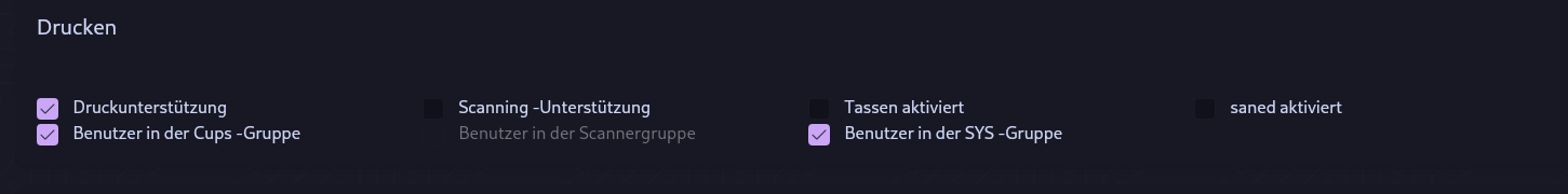

rerun rani and the checkboxes shows this
i can scan without prob + the same with the drag460
rani doesn’t know scanner support is installed + saned is running
or i misinterpret something.

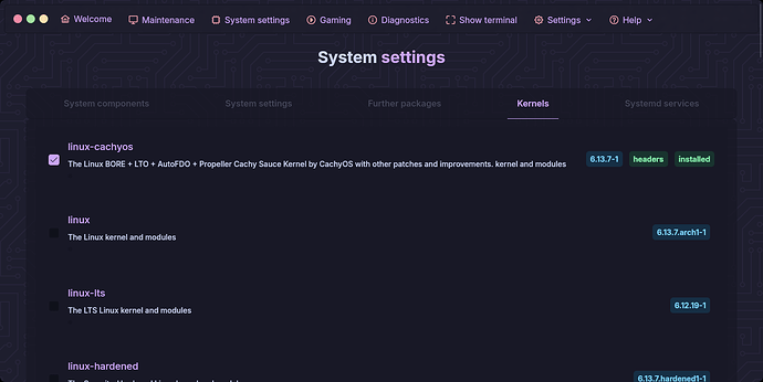

Kernels cool i dont see yet on my git rani.(want install over Garuda Assistant the Zenver3 , LTS and Clear but only installed Lts and Clear no Zenver3)
ps. worked now after the update and Kernels also visible :wink:
Whoa, Kernels…

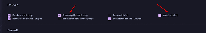

scanning support = enabled …good work @nico
The thing is with the saned. This daemon looks over the network for client ↔ host scanning. (firewall + network must be configured correctly of course for sane)

but rani saned checkboxes show not “running”
Sorry, Nico ..for your todo-list
Just fixed that one, we only checked systemd services and had to expand it to sockets as well. Thanks!
