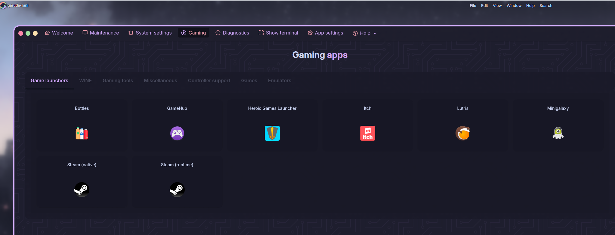

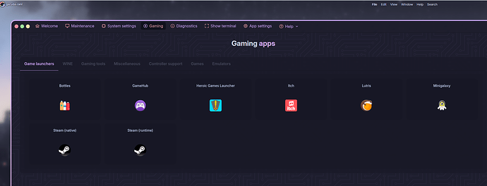

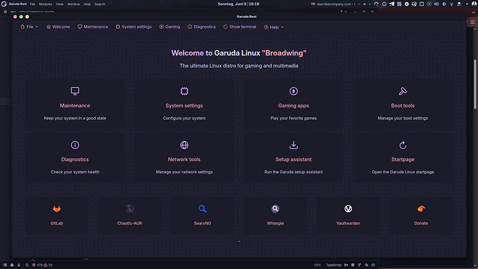

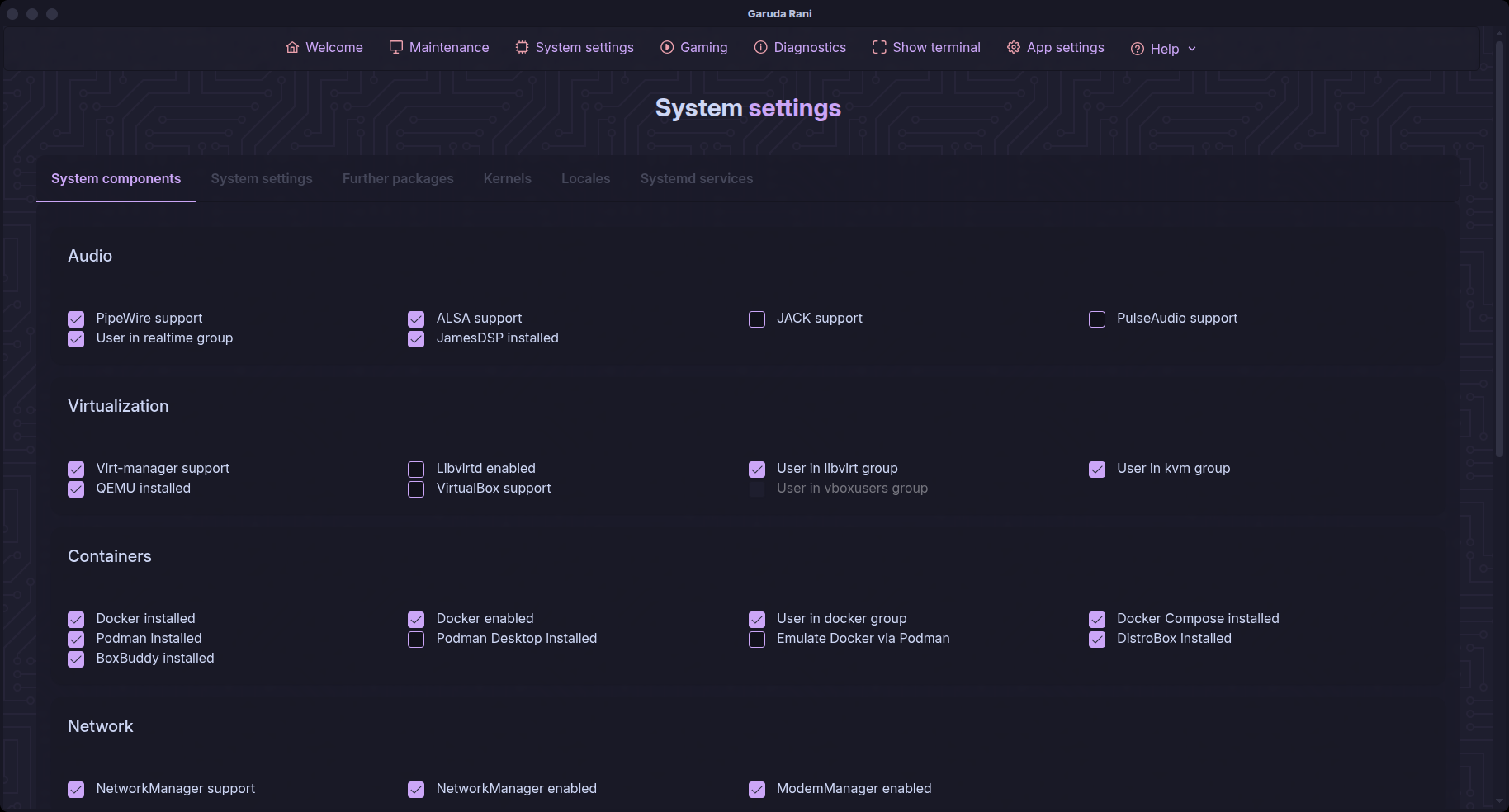

Here is an experimental version of the rewritten app in its current state. From what I can tell most of it works. There is a weird design issue when jobs are scheduled when packaged, gotta fix this still.

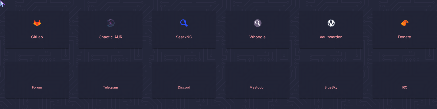

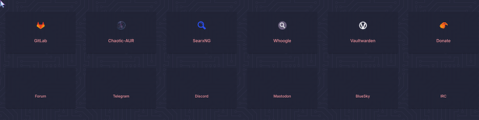

Looks really good, though forum, telegram, mastodon, blusky. and irc are slow to load in an have no placeholder icon. The gaming tab, none of the links there show either. they pop up for a split second an poof. everything else seems to be working and working fine.
I don’t remember if “Further pkgs” was always there but its a really nice touch. For electron its not bad at all. Though to move the app around after resizing it there’s no drag point even at the top, so using meta left click hold is a must.

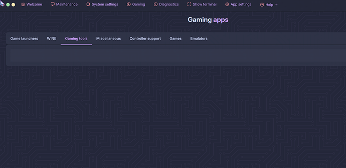

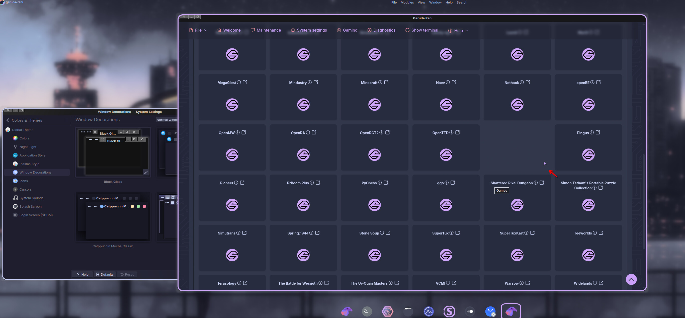

It is really weird, from what I can tell the missing icons are only outside of dev mode. Meh.
What do the logs say when you navigate to the gaming tab?
As for moving around, yes. I guess that needs to be implemented still.
the logs are,
[26411:0607/114505.841630:ERROR:ui/gl/gl_surface_presentation_helper.cc:260] GetVSyncParametersIfAvailable() failed for 3 times!
renderer › [WARN] Package bottles is not available, removing from list
renderer › [WARN] Package gamehub is not available, removing from list
renderer › [WARN] Package heroic-games-launcher-bin is not available, removing from list
renderer › [WARN] Package itch-setup-bin is not available, removing from list
renderer › [WARN] Package lutris is not available, removing from list

though ive only opened this on nix an not arch so that might be the reason. ill give it a try there
*edit - Yeah works fine in mokka its only the main pages social links that don’t show.
I guess there is also no need to fake window buttons anymore with this?
I don’t have gnome set up to test how it would appear without them it should provide a serverside title bar but im not so sure anymore with them
Here’s another build for testing. I don’t want to push it to everyone on -git yet until most things are fixed, so AppImages it is for now. Haha.
Especially, this lets GNOME or GTK env people test how it looks on their DE. Also test the appmenu please.
Most all seems good to me. it handles window decoration changes fine on kde.
However its missing the indication on the “Show Terminal” when you have added something such as lact from gaming or anything from Further packages.
Also in gaming under games there is a empty space
but the global menu works perfectly.

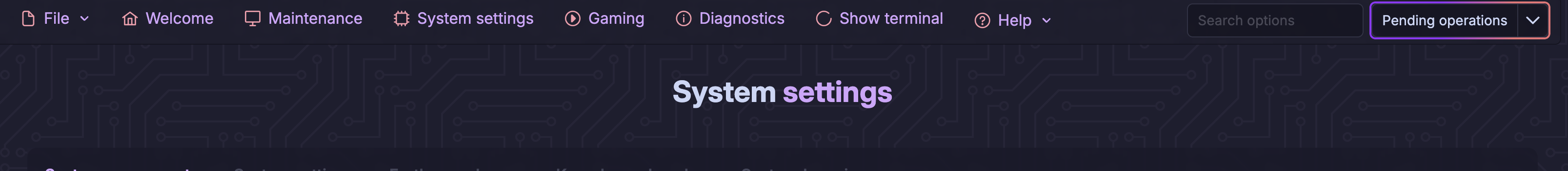

Yes, it broke, and I’ve now moved it somewhere else (people missed it, probably because of not being a separate point). See this:
Here you can either apply or cancel with the dropdown.

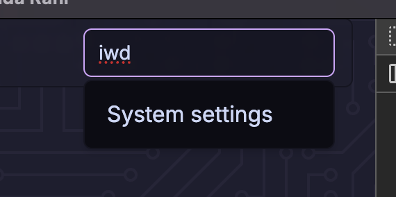

That search got requested by @tbg, and it lets you search and navigate the app by keywords, e.g.:
feat(search): add initial app search (2256532f) · Commits · Garuda Linux 🦅 / Applications / Reliable Assistant for Native Installations · GitLab)
