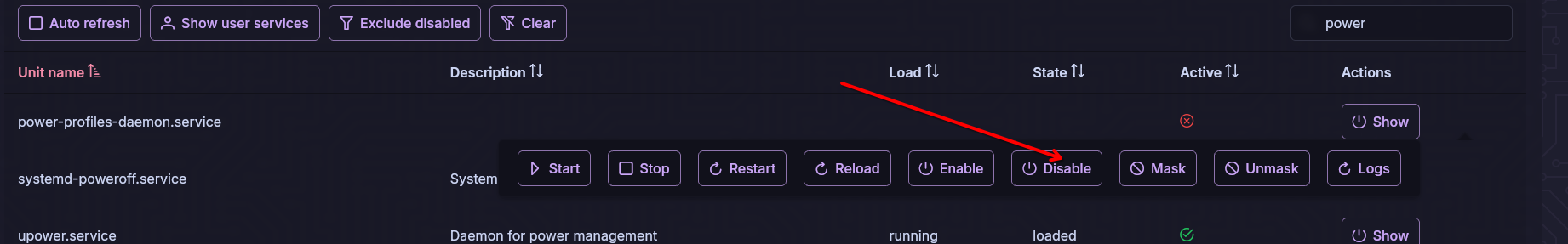

I can’t replicate this behavior. Just so we are talking about the same thing: it is the button right here you used, correct?
As of from what I’ve seen I’d say this issue has nothing to do with Rani.
All which this application does concerning handling service management is running plain systemd commands, there is no fancy custom logic involved whatsoever.
https://gitlab.com/garuda-linux/applications/rani/-/blob/main/src/app/systemd-services/systemd-services.component.ts#L122
You can even observe this in the full journalctl logs (I would’ve been very interested in those logs of your incident):
Apr 06 13:28:38 dragons-ryzen pkexec[356038]: nico: Executing command [USER=root] [TTY=unknown] [CWD=/home/nico/Documents/garuda/rani/src-tauri] [COMMAND=/usr/bin/systemctl disable --now power-profiles-daemon.service]
Apr 06 13:28:38 dragons-ryzen systemd[1]: Reload requested from client PID 356038 ('systemctl') (unit user@1000.service)...
Apr 06 13:28:38 dragons-ryzen systemd[1]: Reloading...
Apr 06 13:28:39 dragons-ryzen systemd[1]: Reloading finished in 472 ms.
Apr 06 13:28:39 dragons-ryzen systemd[1]: Stopping Power Profiles daemon...
Apr 06 13:28:39 dragons-ryzen systemd[1]: power-profiles-daemon.service: Deactivated successfully.
Apr 06 13:28:39 dragons-ryzen systemd[1]: Stopped Power Profiles daemon.
Could you possibly give this another try and provide the logs like that?

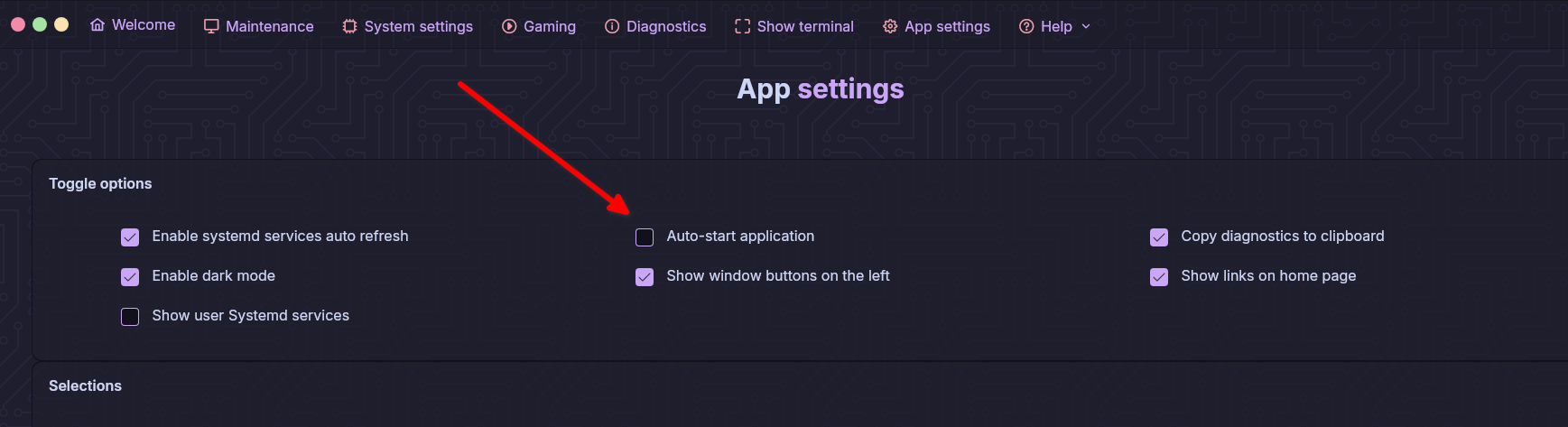

The way it works is that it it places a .desktop in ~/.config/autostart, and removes it.
I just verified that it indeed works this way. Does your folder contain such a file? I have a certain assumption, haha. org.garudalinux.rani.desktop or similar exists maybe?

Youre are right @dr460nf1r3 ,
ive deleted those file but i was on normal rani because ive installed on new other ssd. I did installed afterwards the git version and it wrote those file again in so i deleted it again and now its working. Thanks for that hint again would not expect that comes back :wink:
After each upt or de +install or changing sys settings → reboot. (perhaps sometime it is not a must.. but i do this) :innocent:

Ahh… rani is always auto starting in new hyprland ISO .
I thought that the following option is for stopping it :
but it is not IG… not stopping from autostart …
is there any option to stop it from auto start ???
hi Ankur,
i had the same issue see this one Garuda Rani - preview releases and testing - #227 by dr460nf1r3 or scroll up check this folder ~/config/autostart
