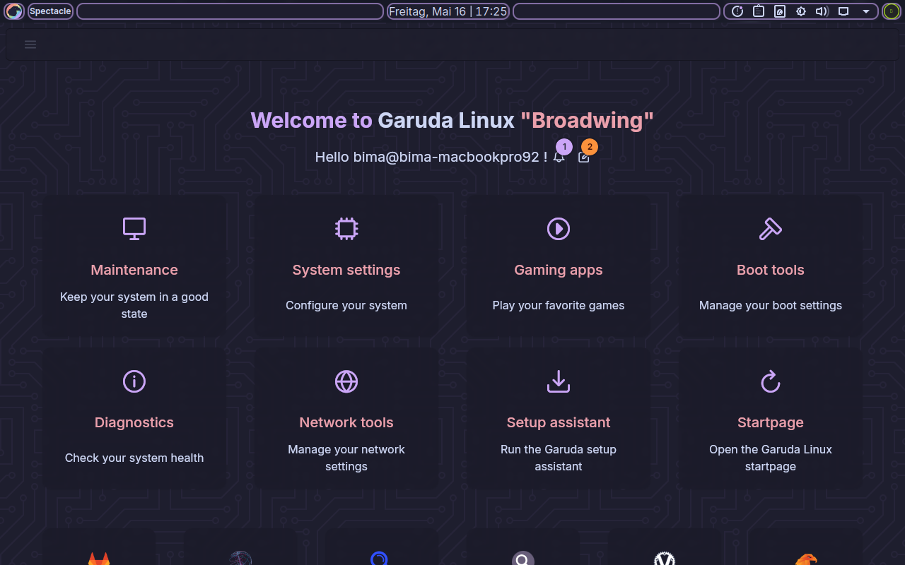

Please, reboot, try again and if the issue persists open a terminal, enter
copy the output and post it here.
That’s happened to me too.
I just checked all my Garudas (6) and everything is fine.
@Sunda-Spirit can you also post garuda-inxi of the affected machine?
So 1 of 6 will not open rani, correct? Is there anything different about that one from the rest that are fine?
Sorry for the misunderstanding.
I wanted to point out that all 6 Garudas work fine with rani.

garuda-rani generally works with Wayland, neither a workaround nor a switch to an x11 session is necessary. That’s why you should do this:
So we would probably have found the real cause.
I uploaded to pastebin 2 days ago logs from journalctl with errors for Rani
I saw that, but you and the other two users in the corresponding topic have a different issue with garuda-rani. That is not helpful here in this thread. :slight_smile:
how can i do now? i have reinstalled garuda mokka as i said in my previous reply .
and its opeing now and all is fine now…
i think @Sunda-Spirit has still that problem.
I only encountered this error once.
After reopening Rani, everything was fine, without having to reinstall.
