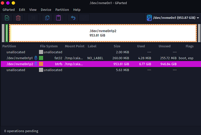

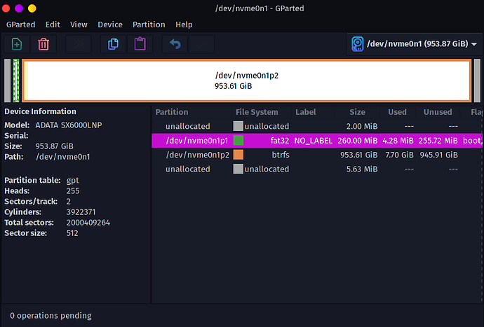

I tried to do what @Stroke_Finger suggested and used the "Erase the disk" option while installing Garuda and I'm still getting the same error.
EDIT: The first partition is now 2 MB after the failed install.

The disk appears to be gpt partitioned. My bios doesn't seem to tell anything useless. I've been reinstalling countless times to no avail.
What should I do now? What information is needed?
You need to patiently go through the BIOS settings and find a choice between UEFI/GPT + Legacy and select UEFI.
