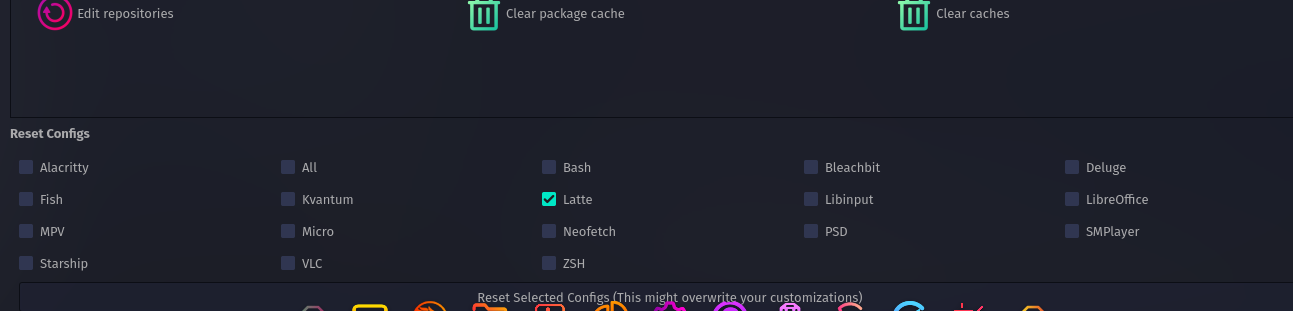

Kill Latte-Dock, and restore with garuda-assistant.
please, how do I kill and restore with garuda-assistant? Any specific commands?
Check htop tray on the bottom, search latte-dock, kill.
Before open garuda-assistant.
I killed latte-dock but now there's no dock on my screen.
Please read
Mark latte-dock and click the button.
Check latte and reset config
