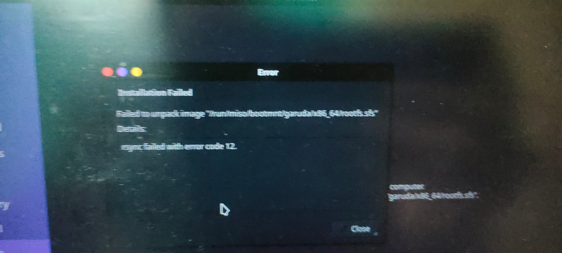

So let’s start from start, I had my garuda linux working well and fine, then i received a system update message, I did it while doing so idk how my system went to sleep mode, I opened it and it showed the update failed , tried running other application but nothing was working, I restarted my laptop, It show kernel was missing, I had no other option but to reinstall the O.S.
I tried reinstalling the linux(flashed my usb drive with rufus) and every time i did it it showed failure

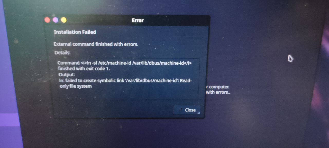

similar to this
Then today, I flashed my usb drive with etcher, it was good until another failure showed up ,check the image
What to do now
