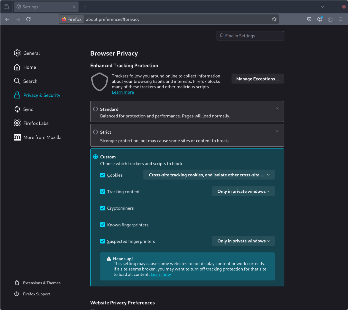

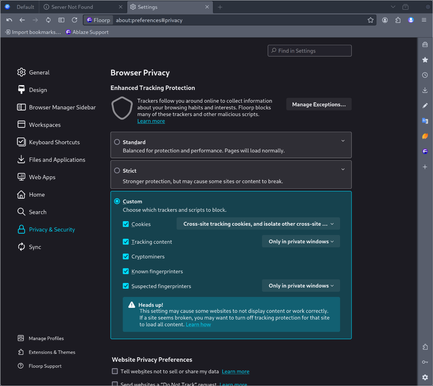

I installed Floorp and Firefox just now to test, and they both have this UI menu enabled by default.
This menu is disabled, since FireDragon forces Strict-Mode by default, which makes this setting reset with each browser restart. So there is no point in showing it.
