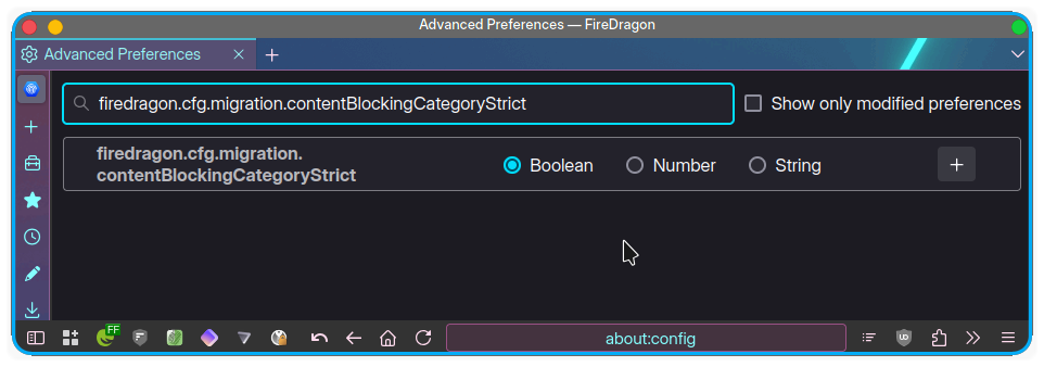

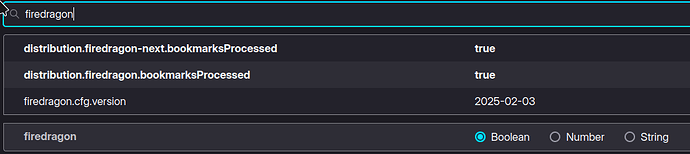

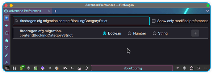

Can you check the pref firedragon.cfg.migration.contentBlockingCategoryStrict in about:config, is it set to true?
In my tests, it always correctly migrates the content blocking category from “Strict” (previously being forced) to “Standard” (which is the default, but which is now equivalent to the “Strict” mode of regular Firefox/Floorp).
