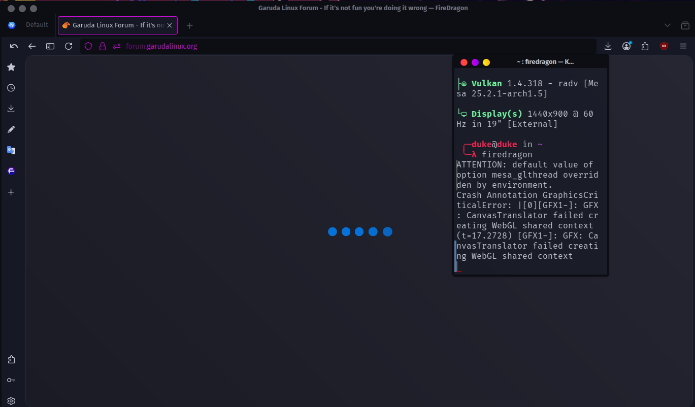

Good morning,
i have this issue. website isnt loading or i have to reload few times. I dont know if its related to the DNS problem (cant connect to website error looks like the DNS problem)but here the error. Also the bookmark line disapears may just some setting but wasnt on the 11 version. the downgrade didnt show me the 11 version.
firedragon
ATTENTION: default value of option mesa_glthread overridden by environment.
Crash Annotation GraphicsCriticalError: |[0][GFX1-]: GFX: CanvasTranslator failed creating WebGL shared context (t=17.2728) [GFX1-]: GFX: CanvasTranslator failed creating WebGL shared context
Crash Annotation GraphicsCriticalError: |[0][GFX1-]: GFX: CanvasTranslator failed creating WebGL shared context (t=17.2728) |[1][GFX1-]: RenderCompositorSWGL failed mapping default framebuffer, no dt (t=322.859) [GFX1-]: RenderCompositorSWGL failed mapping default framebuffer, no dt
╭─duke@duke in ~ took 16m6s
╰─λ
