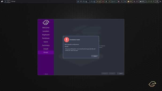

When I try to install the garuda-dr460nized-linux-zen-240824.iso I get the following error:
I tried to install it on different disks and I get the same error.
On the other hand it is the first bootable test iso since April 24.
I hope you will enable the test isos again to allow us to test the new features and report our comments.
Thanks in advance and keep up the great work you are doing.

Use the download link from homepage, not the developer version. Please.
Hi !
I installed the 08.24 build without any problem, in UEFI.
Works very well.
and this is not first working ISO , because the 08.23 build is same, 100% perfect bootable and installable.
That is interesting to hear. Did you install in a VM or on the metal?
Baremetal, with Nvidia proprietary drivers.
and found zero error, entire system works like a charm.
i vanted one fresh .iso , and this is perfectly.
Hmm, the plot thickens…
@Dr.Fanatik-US can you post to the thread your garuda-inxi output? I’m not sure, maybe it will hold a clue for us.
of course.

SGS
Split this topic
28 August 2024 12:17
10
I tested on an AMD laptop just now in case it was another Intel/AMD thing, but it looks like it must be something else…

Local Storage: total: 592.44 GiB used: 6 MiB (0.0%)
model: MZVLB512HBJQ-000H1 size: 476.94 GiB block-size: physical: 512 B
fw-rev: HPS0NEXF temp: 31.9 C scheme: GPT
ID-2: /dev/sda maj-min: 8:0 vendor: Kingston model: DataTraveler 3.0
size: 115.5 GiB block-size: physical: 512 B logical: 512 B type: USB
fw-rev: PMAP scheme: MBR
ID-1: swap-1 type: zram size: 15.01 GiB used: 0 KiB (0.0%) priority: 100
System Temperatures: cpu: 89.4 C mobo: N/A
Memory: total: 16 GiB note: est. available: 15.01 GiB used: 2.87 GiB (19.1%)
Processes: 296 Power: uptime: 11m states: freeze,mem,disk suspend: s2idle
image: 5.97 GiB services: upowerd Init: systemd v: 256 default: graphical
Packages: pm: pacman pkgs: 1176 libs: 357 tools: pacseek,paru Compilers:
gcc: 14.2.1 Shell: garuda-inxi default: fish v: 3.7.1 running-in: foot
inxi: 3.3.35
System install date: 2024-08-16
Last full system update: 2024-08-16 ↻
Failed units: snapper-cleanup.service
Hmm …
I finished installation without any error, writed the 08.24 .iso to USB with Rufus in Windows in DD mode, MBR partition table, (if count?) …
installed System in UEFI, created one /boot/efi partition 307 Mb + one /boot partition 2 Gb flag as boot. (this is essential .))
++ one for system + separate home partition …
installed even in Virtualbox, UEFI, succesfuly.
Maybe my issue is due the fact that I used Ventoy.
I’ll try to flash the iso using balena
Confirmed, the problem was solved by flashing the ISO on the pendrive with Balena instead of using Ventoy.
system
Closed
1 September 2024 21:54
