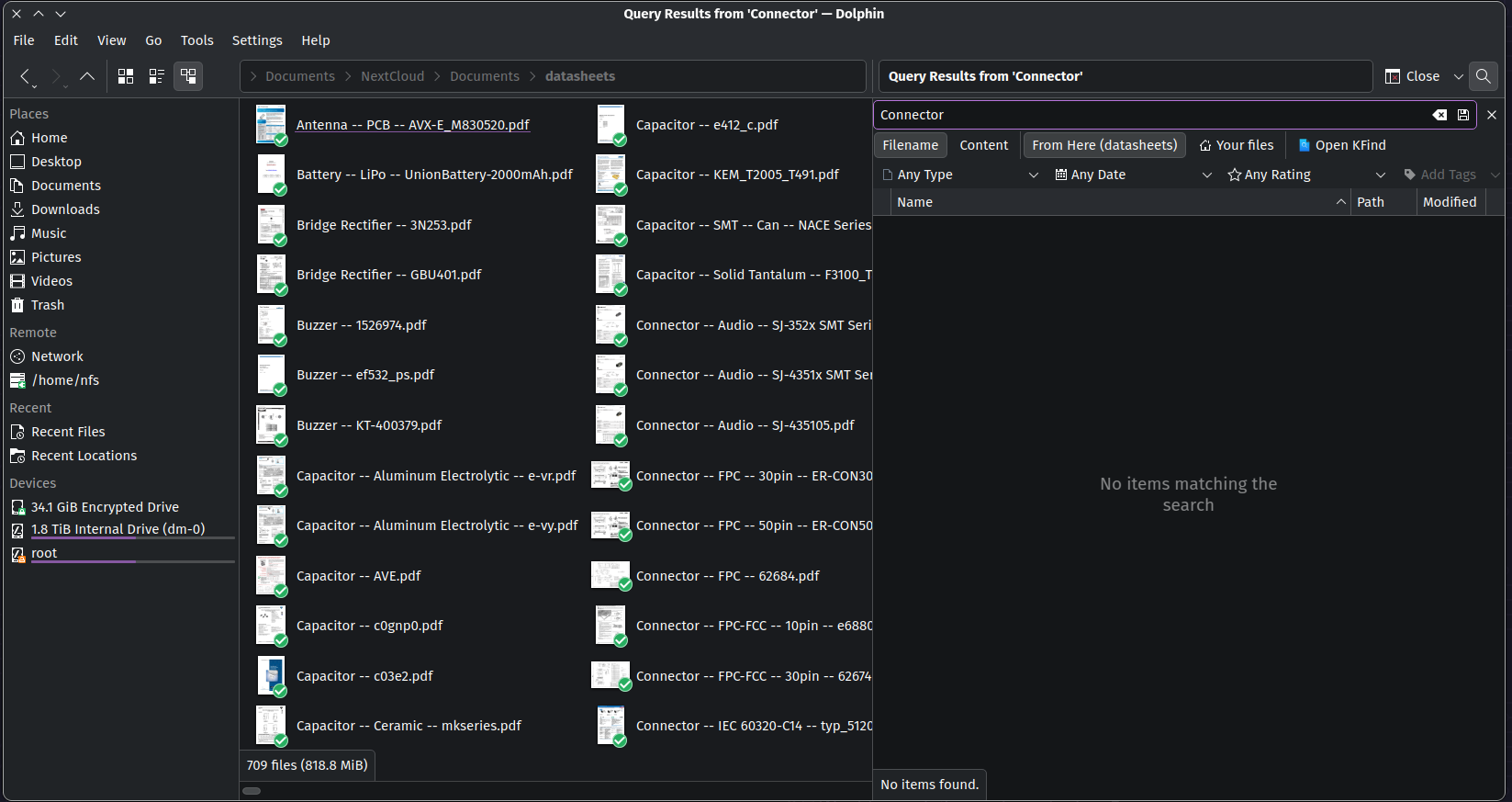

Using the search input in a Dolphin window does not work.

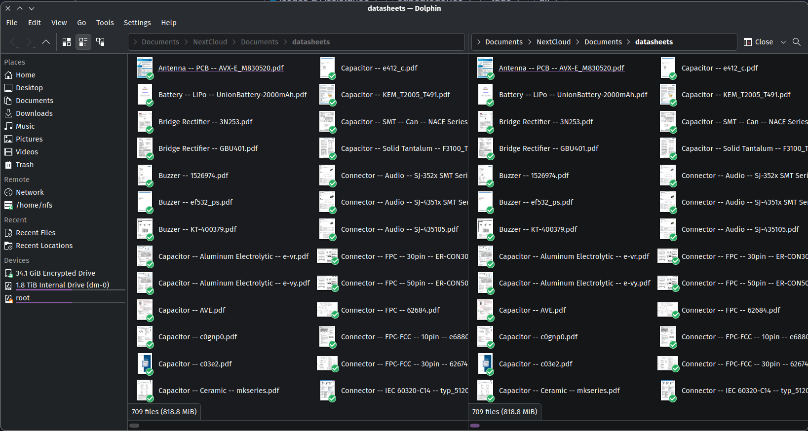

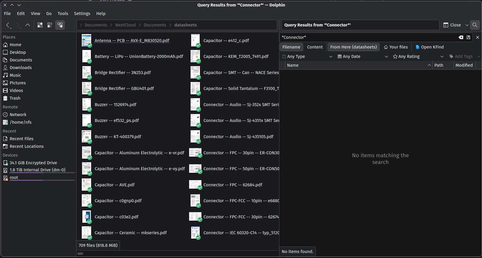

When entering any search string, the result is always “No items matching the search”. I know that it is frowned upon when proof is submitted in form of screenshots, but it suits the case best so here it goes. The first screenshot shows the actual contents of the directory, and you can see the file names starting with “Connector …”. The second screenshot shows the results of the search for “Connector”. I would have expected the file list to be reduced to all files that contain “connector” in the name, not to nothing. When searching the same folder with KFind, the search works as expected and I get a proper list of files.

Your first search assumes wildcard matches, so it specifically searches for exact matches of what you typed *Connector*, if you remove the * on both ends it will find all matches. As you noticed, the second does not assume anything, and honors the wildcard (*) in your search input.
I have ideas, but no proof on why they function differently, but would say that would be a question for the KDE devs if you wanted the “why” and/or think this is a bug.

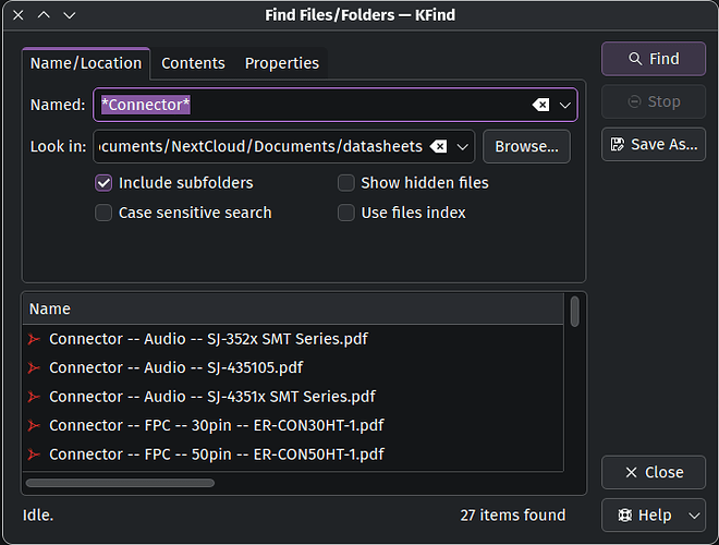

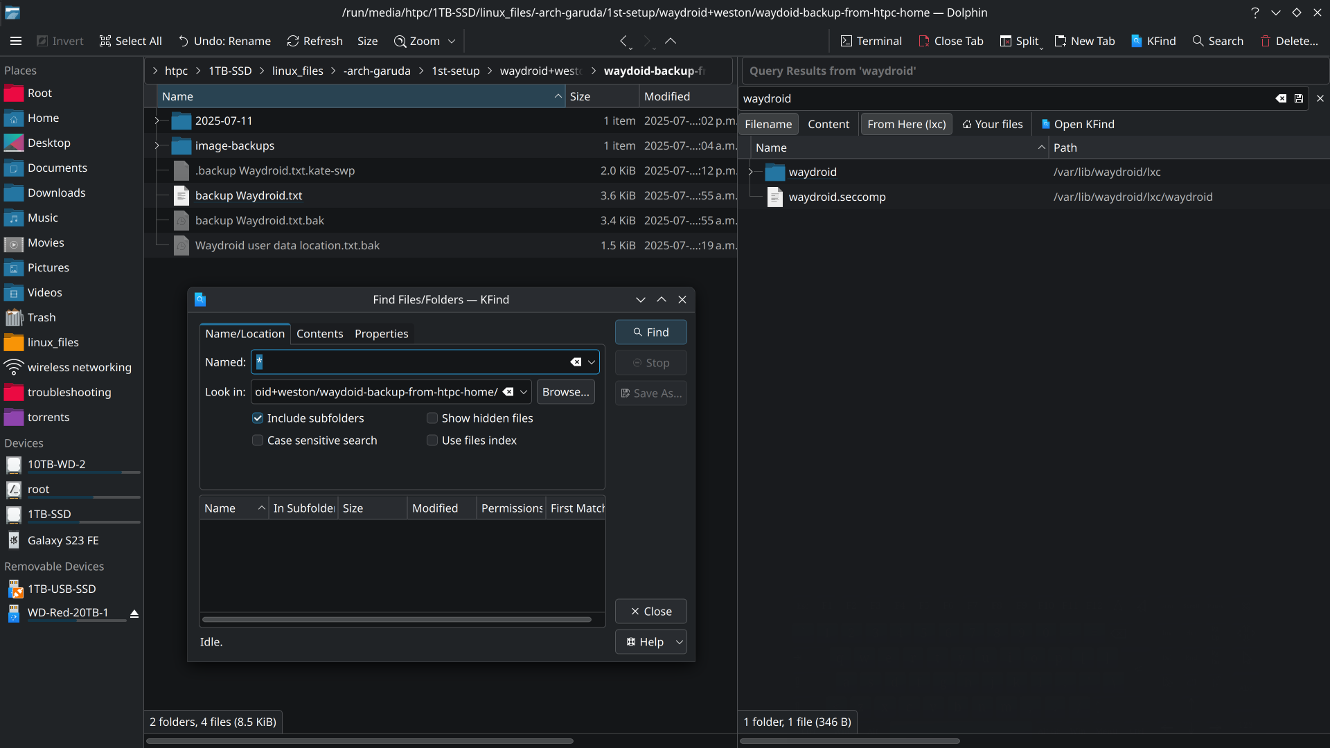

Obviously not a proper fix, but try installing kfind, (if you don’t already have kfind installed). KFind has better search options than Dolphins inbuilt search function IMO. KFind can be set to appear as another search option in Dolphin, so it’s a little more seamless than a separate external search app, (especially a GTK search utility).

Unfortunately, your statement about the wildcard matches is incorrect. Even without that, nothing is found. This is the point I was trying to make, no matter what I type, as soon as I enter any search term, the result is “nothing matches the search criteria”.

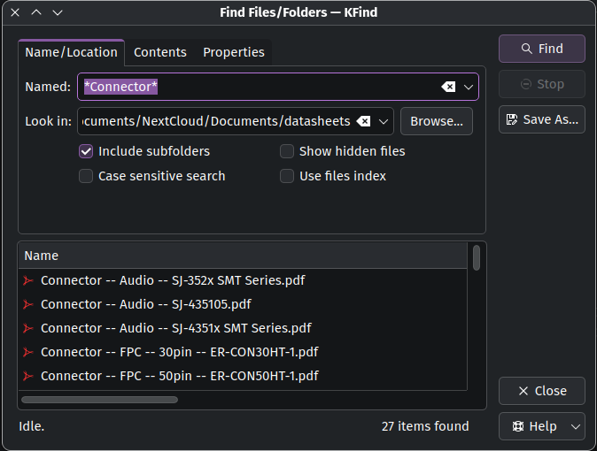

Thank you for the suggestion. My initial post also includes a screenshot from KFind as proof that it can search through my files and the problem was with Dolphin search itself, not with the lack of stuff to be found.
As to your mentioning setting KFind as search backend, I have looked through the settings of Dolphin and also in System Settings, but failed to find this option. KFind itself did not have any menus, at least I couldn’t open any (Ctrl+Shift+M did not open a menu bar…). Can you point me to the correct location for this setting please? Thanks!
You can add a kfind button to your dolphin toolbar (look closly in my screenshot), that was what I was meaning when I stated:

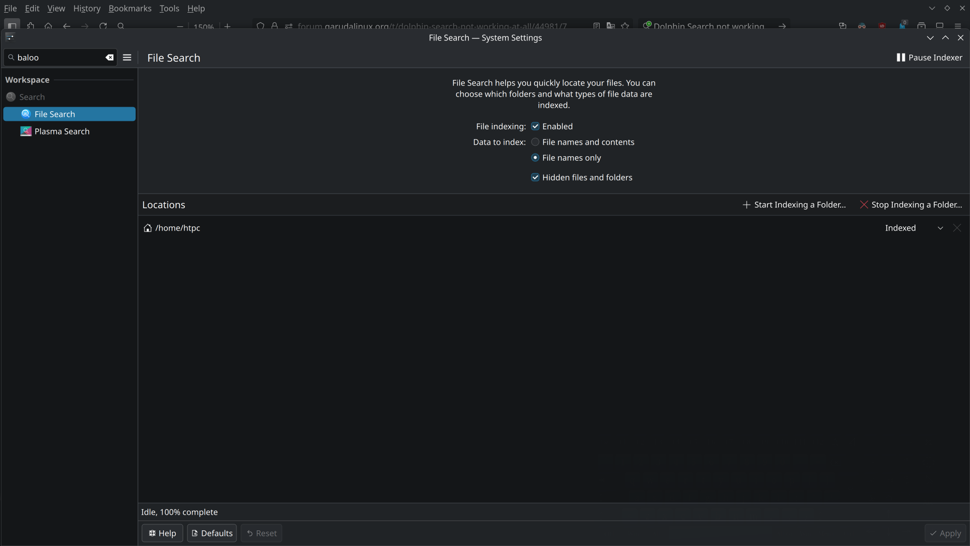

Do you have “File names and contents” indexing enabled?
See my screenshot of the KDE System Settings:
Have you tried re-indexing Baloo?
