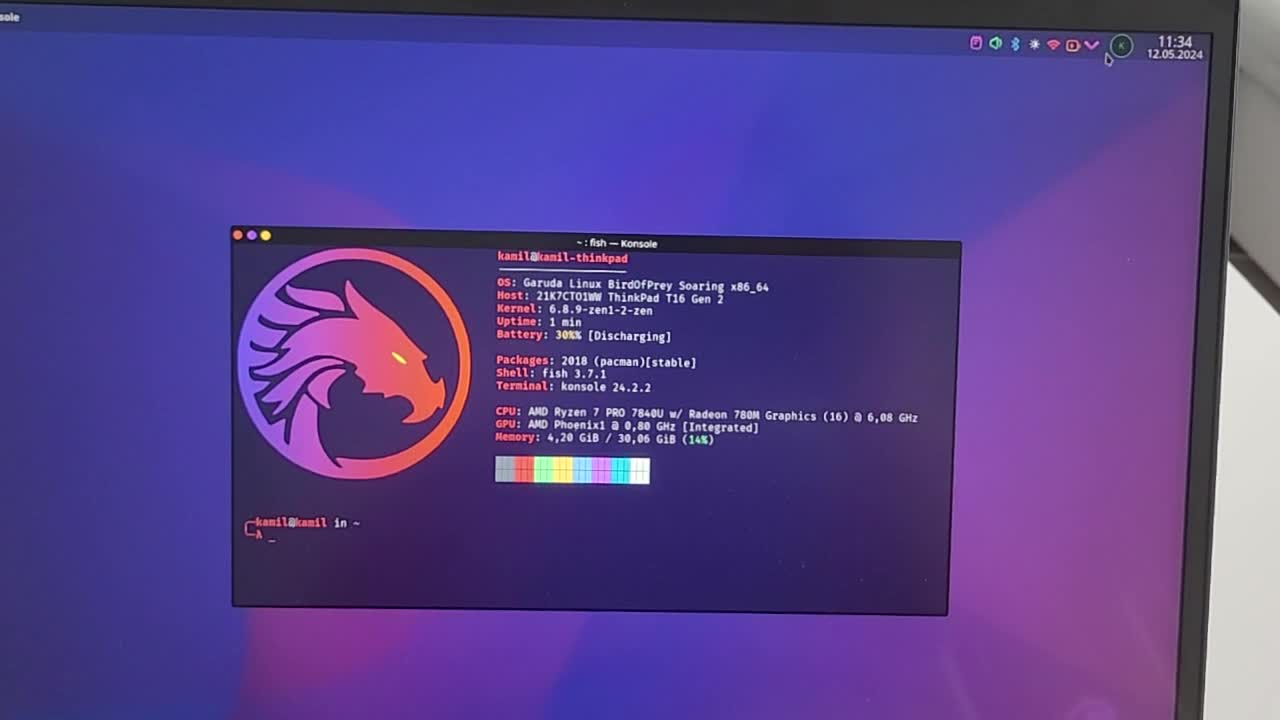

Does not shut down completely
I have ThinkPad T16 Gen2, and sometimes my system does not shut down completely. I mean, the screen is black, but the keyboard light is still on, and I can hear the fan spinning. Furthermore, I cannot switch to another desktop, nor use ESC to display detailed information.

I can easily reproduce the issue. I just need to put the laptop to sleep, wake it and try to restart. There is no any output, even with Regular Boot.
Recorded a video of the process.
I tried some “sleep” experiments on my laptop. If I try to log in, after closing my lid and reopening, the system becomes unresponsive for a few seconds and after logging in, there is no background (black screen) and no docks/panels. But all the shortcuts still work.
However, if I manually put it to sleep form the application launcher, and then wake it up, everything works fine.
Also, I put the laptop to sleep manually and then closed the lid and then reopened it. It woke up and I logged in normally. Shutdown was normal too.
Even tried with the LTS kernel, and the issue was present.
Try to manually put it to sleep
