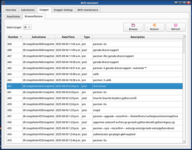

Ok this worked however I got a new problem….
I went into BTRFS assistant and selected:
I haven’t reset my computer yet….how do I abort the restore so I don’t lose what I just fixed?
