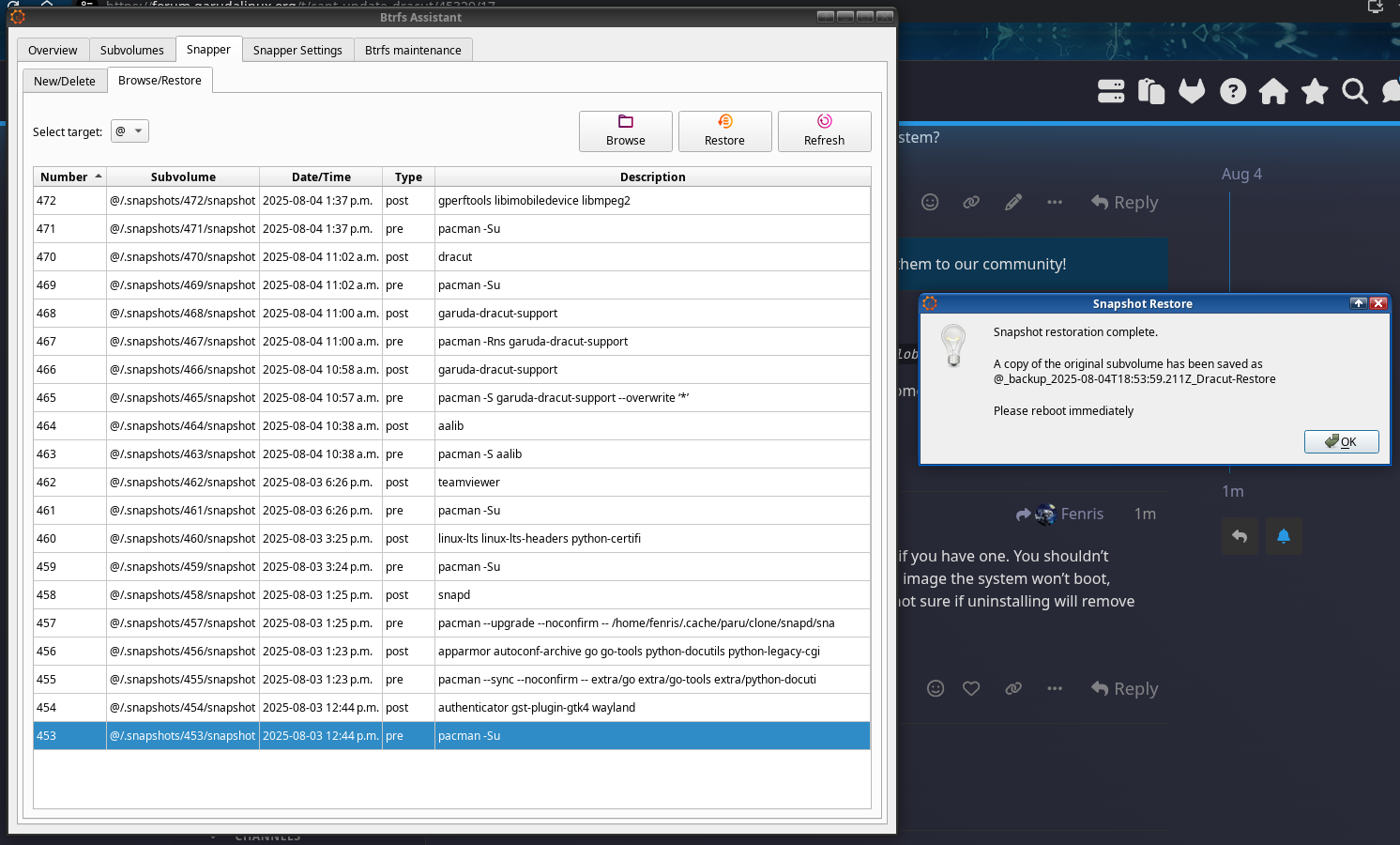

I just did this, selected the last line which was yesterday and clicked Restore…
Will I be alright?
