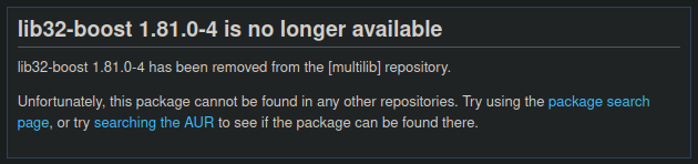

No, that warning message is not why the update is failing. This is why the update fails:
lib32-boost is actually gone now. On the updated mirrors it isn’t even available in the multilib repo anymore:
pacman -Sii lib32-boost
error: package 'lib32-boost' was not found
The page for this package displays this message:
ss_09-02-23-215412
Nothing depends on this package anyway; you should be fine to just uninstall it.
sudo pacman -R lib32-boost
Then proceed with the update.
garuda-update
