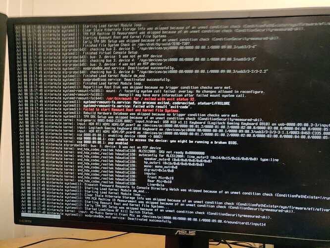

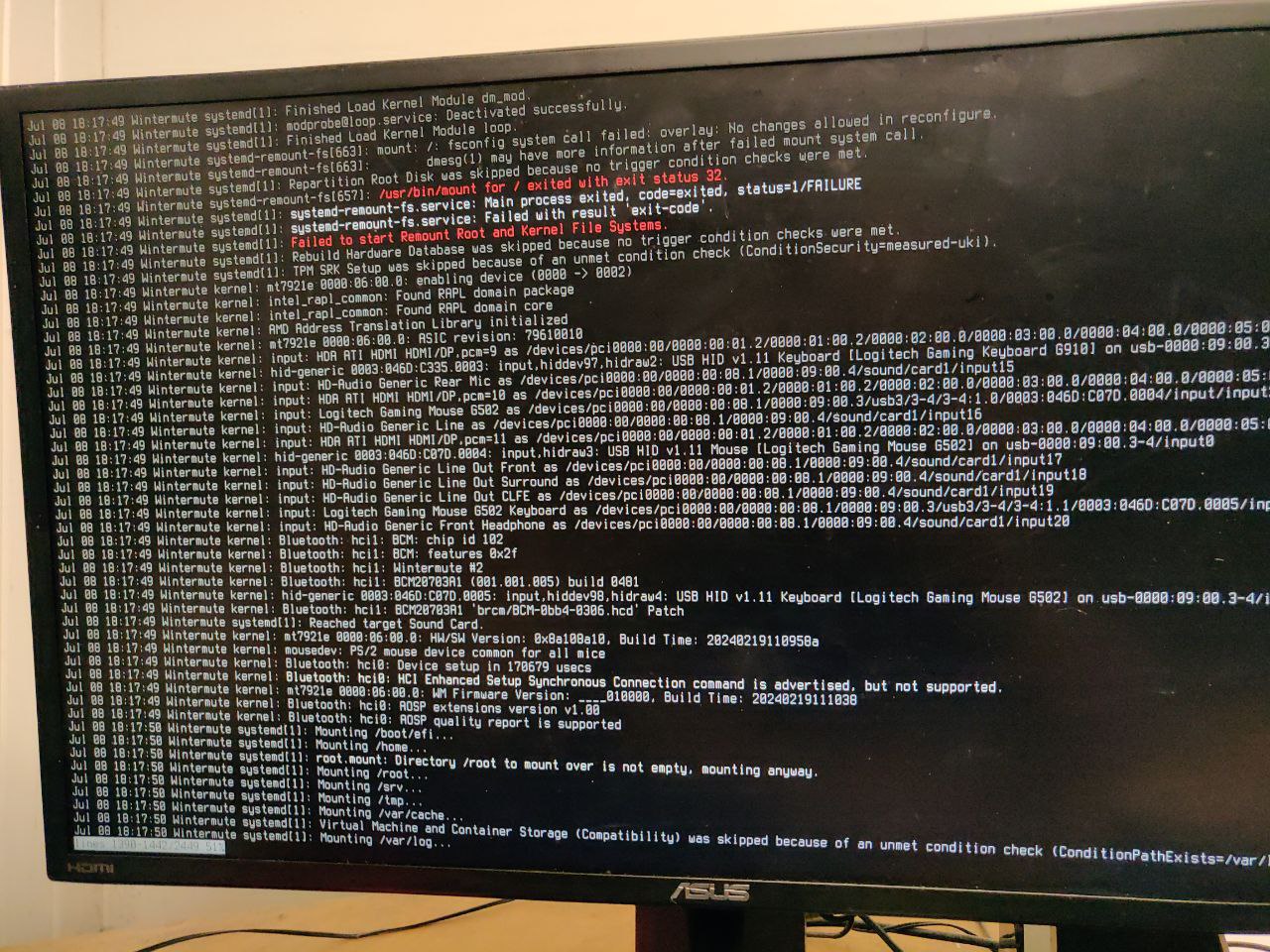

I had another go at it and it appears that after I select a snapshot, at the top (which I didn’t quite realize at first) there were some additional errors, systemd[1]; Failed to start Remount Root and Kernel File Systems and hid-generic 003:0D8C:0005.0006: No inputs registered. leaving

-b -1 is from when I attempted to boot into a snapshot, or was the only log from that point in time. I can try again just in case all the same.
Okay so… I tried booting into one again to grab the log but journalctl isn’t showing me the session. The output of journalctl --list-boots shows the following

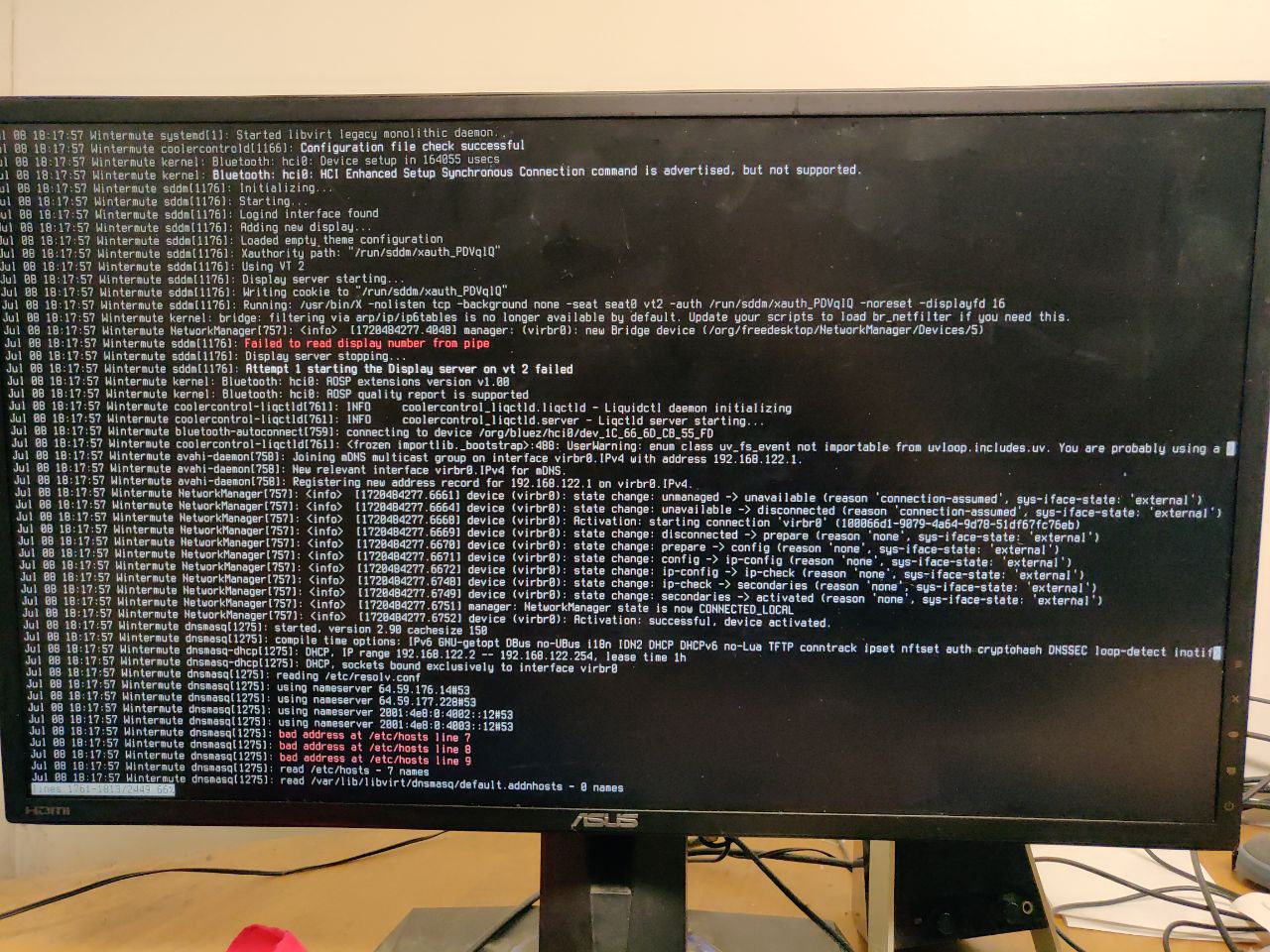

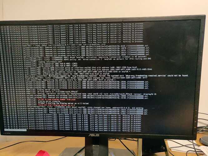

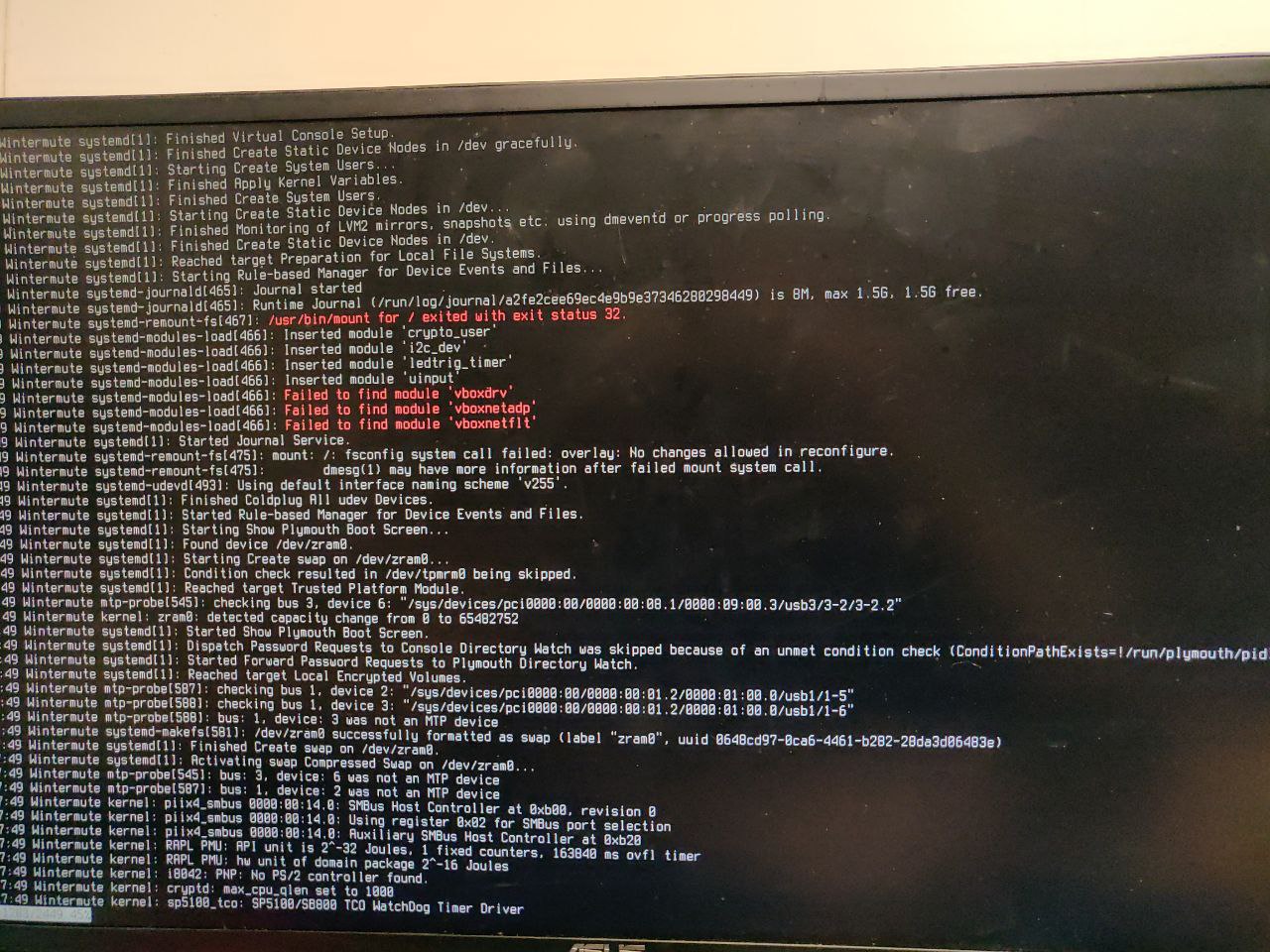

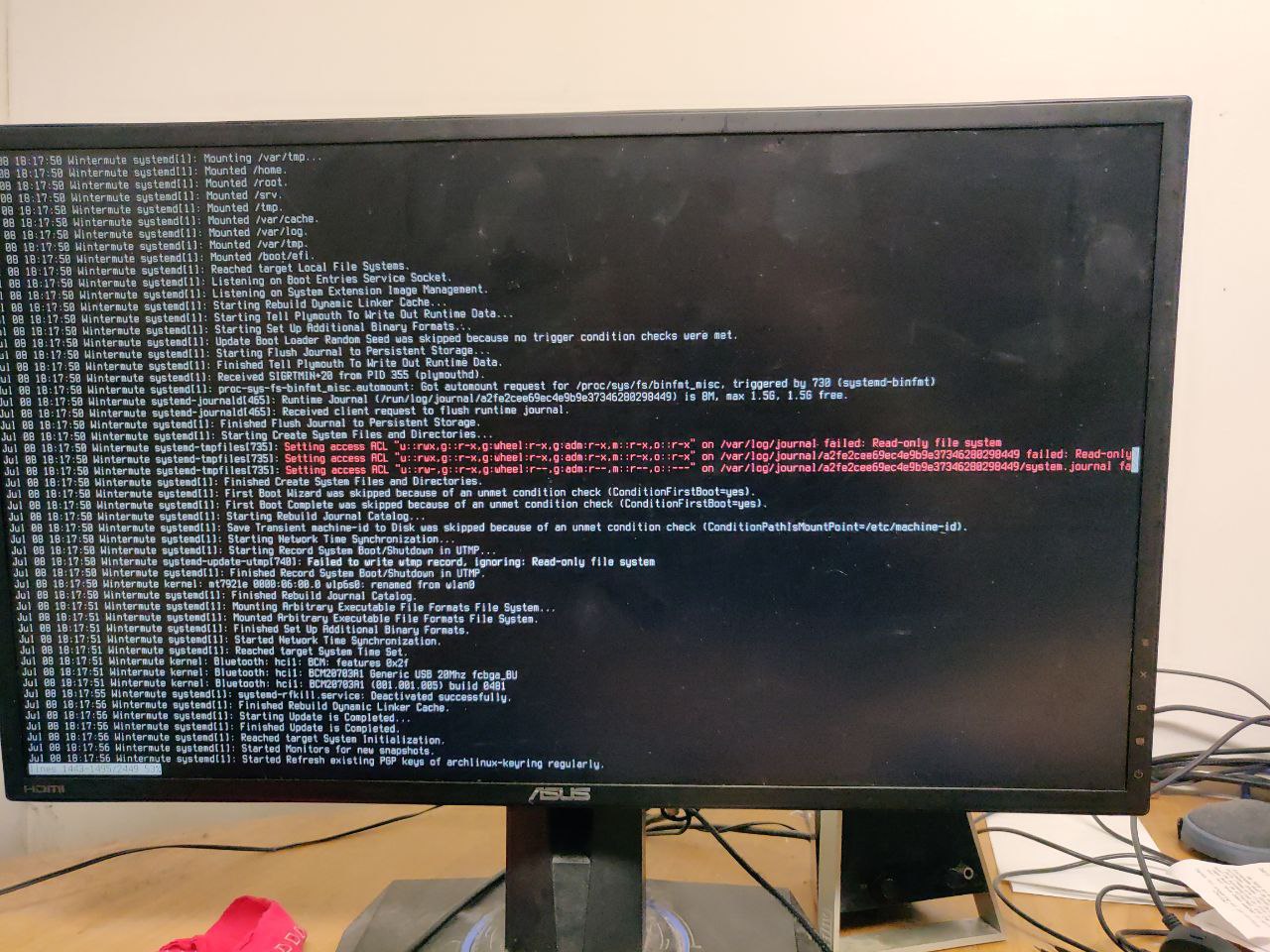

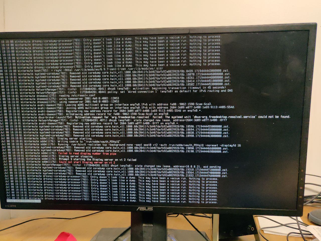

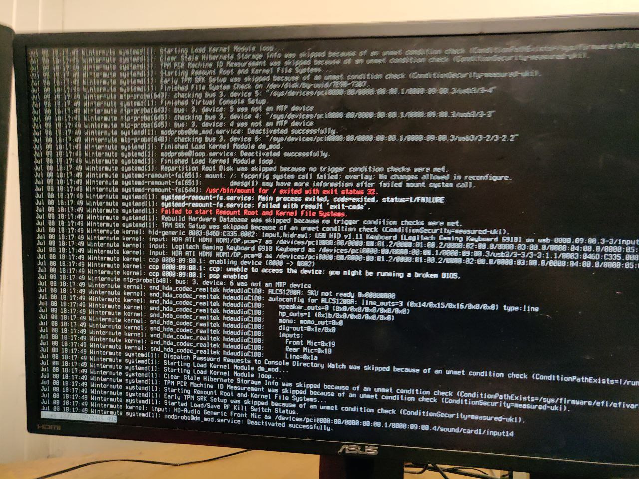

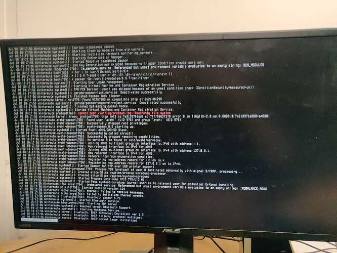

Okay so I had some free time to do some more looking into this.
I booted back into a snapshot and tabbed over to a TTY and logged in and opened up journalctl -bb 0 and grabbed some pics of the log I thought might be relevant, which are below. There were some errors about the display server failing to start, though I did get the idea to try running startplasma-wayland and that seems to have worked in getting everything up visually. It was notably slow however and kept throwing errors at me about everything being in read-only but I did eventually get in and was presented with the option from Snapper to restore the snapshot.
Summary
I couldn’t upload two and they are instead here

==> Starting build: '6.9.8-zen1-1-zen'
-> Running build hook: [base]
-> Running build hook: [udev]
-> Running build hook: [microcode]
-> Running build hook: [modconf]
-> Running build hook: [block]
==> WARNING: Possibly missing firmware for module: 'aic94xx'
==> WARNING: Possibly missing firmware for module: 'bfa'
==> WARNING: Possibly missing firmware for module: 'qed'
==> WARNING: Possibly missing firmware for module: 'qla1280'
==> WARNING: Possibly missing firmware for module: 'qla2xxx'
==> WARNING: Possibly missing firmware for module: 'wd719x'
==> WARNING: Possibly missing firmware for module: 'xhci_pci'
-> Running build hook: [keyboard]
-> Running build hook: [keymap]
-> Running build hook: [consolefont]
-> Running build hook: [plymouth]
-> Running build hook: [filesystems]
-> Running build hook: [grub-btrfs-overlayfs]
==> Generating module dependencies
==> Creating zstd-compressed initcpio image: '/boot/initramfs-linux-zen-fallback.img'
-> Early uncompressed CPIO image generation successful
==> Initcpio image generation successful
sudo update-grub
Found theme: /usr/share/grub/themes/garuda-dr460nized/theme.txt
Found linux image: /boot/vmlinuz-linux-zen
Found initrd image: /boot/initramfs-linux-zen.img
Found fallback initrd image(s) in /boot:  initramfs-linux-zen-fallback.img
Found Windows Boot Manager on /dev/sdd1@/EFI/Microsoft/Boot/bootmgfw.efi
Adding boot menu entry for UEFI Firmware Settings ...
Detecting snapshots ...
Found snapshot: 2024-07-09 11:12:18 | @/.snapshots/1038/snapshot | post | botan botan2 corectrl discord dxvk-mingw-git gdb gdb-common keepassxc li |
Found snapshot: 2024-07-09 11:11:52 | @/.snapshots/1037/snapshot | pre  | pacman -Su                          |
Found snapshot: 2024-07-08 10:36:13 | @/.snapshots/1036/snapshot | post | abaddon-git b43-fwcutter blender btrfsmaintenance ca-certificates-mozill |
Found snapshot: 2024-07-08 10:35:18 | @/.snapshots/1035/snapshot | pre  | pacman -Su                          |
Found snapshot: 2024-07-04 13:58:15 | @/.snapshots/1034/snapshot | post | abaddon-git adobe-source-code-pro-fonts aha akonadi akonadi-calendar ako |
Found snapshot: 2024-07-04 13:57:04 | @/.snapshots/1033/snapshot | pre  | pacman -Su                          |
Found snapshot: 2024-06-26 17:33:53 | @/.snapshots/1032/snapshot | post | abaddon-git balena-etcher blender boost boost-libs bullet-dp electron31  |
Found snapshot: 2024-06-26 17:33:43 | @/.snapshots/1031/snapshot | pre  | pacman -Su                          |
Found 8 snapshot(s)
Unmount /tmp/grub-btrfs.EGFnpPhWCZ .. Success
done
That looks fine as far as I can tell. You added the GRUB_EARLY_INITRD_LINUX_STOCK='' line to /etc/default/grub before regenerating right?
When you tested booting a snapshot, did you use a new snapshot (i.e., one that was created after making these changes)?
Alternately you can update grub-btrfs.cfg by running the script in /etc/grub.d:
sudo /etc/grub.d/41_snapshots-btrfs
Then regenerate the Grub config again.
sudo update-grub
