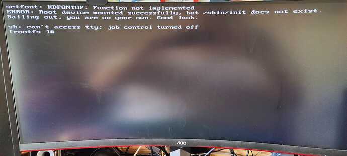

Hey guys,
so i did an update today, it installed KDE 5.27...i accidentally clicked on yes regarding the theme migration and it destroyed my rice (i thought it would just change the things, not activate them).
I didn't want to make all the necessary changes right now and wanted to just reboot into a snapshot from before the update and deal with that stuff later...
Interestingly, after that update i cannot boot into ANY snapshot anymore. Regardless of how old or new it is, regardless if i use the fallback or lts kernel...I know that i could boot into snapshots yesterday BEFORE the update just fine.
This is what i get:
I then made a new manual shapshot with the update in place (so as it is right now) and can't boot into that one aswell...so yeah my snapshots are broken somehow. I really really want these to work... can someone help me out here?

Your snapshots work, you just can't boot into any of them. Can you share your /boot/grub/grub-btrfs.cfg?

Try switching to a TTY and restoring a snapshot from the command line as described in that thread and see if you have any better luck.
Well the difference is i CAN boot. There is 0 problem with my current system. It ONLY effects my snapshots.
And tbh i don't want to risk my installation by restoring a snapshot that doesn't work.
If you boot into a snapshot that "doesn't work", just don't restore it. :man_shrugging:

It's not a specific snapshot that doesn't work. It's all snapshots, regardless of how old or new, that don't work.
So as of right now, i cannot use the snapshot functionality and cannot rely on my system backups. So if i were to brick my installation right now, my system would be lost and i could not restore any snapshot.
I didn't try "booting" into a snapshot from commandline because i don't know how. You said i should RESTORE a snapshot from TTY and that is something i don't want to do right now as my installation is working right now and i don't want to brick it by restoring snapshots that don't work.
To summarize:
My installation works fine, i can boot it, i can use it, 100% works. But if i go into the Snapshot section in grub when booting, and trying to boot in ANY of the snapshots (even ones i made just seconds ago on my working system) i get the "bailing out bcs sbin/init missing" error.
I can then easily reboot into my system and use the current installation, but i don't have access to ANY of my snapshots, making the backup / snapshot system broken right now.
That stresses me out because i need to have a working snapshot system in the case i break my installation at some point...

yeah alright, so restoring a snapshot from my working system DOES indeed work and does NOT brick my boot lol
So that means i have 95% working snapshots, that will save me in any case that allows me to still access my system. If i break that however...i cannot access this...
I assume i would still be able to boot into a live-usb of garuda and chroot into my install maybe? And restore the snapshot from there? But that is certainly a much more in-depth process than simply chosing the last working snapshot in grub.
@bluepower - sadly restoring a snapshot did not repair the grub-functionality :frowning:
Yes, you can always restore a snapshot from the live system. That would be sort of the "original" way to restore a snapshot. The method is described here: Snapper - ArchWiki
It obviously more clunky than the grub-btrfs system where you just choose a snapshot from a menu and it's done, but it is a good backup plan. You can also use Btrfs Assistant from the live environment.
Regarding the actual issue, I cannot figure out how to reproduce this issue. The /boot/grub/grub-btrfs.cfg posted above does not contain any obvious clues to me, all those snapshots look pretty much normal.

I brought up a fresh KDE lite installation yesterday, and booting to snapshots is working out of the box. I even have non-standard root subvolumes set up and Grub still automatically finds the snapshots and booting to them works fine.
Now that I think of it, I guess I did reinstall Grub and regenerate the configuration file on the back of changing the default subvolumes. It seems like a long shot, but have you tried doing that yet?
sudo grub-install --no-nvram
sudo update-grub

Updating grub said it found 28 snapshots, memtext86+ and my linux images and fallback...But this problem persists beyond a kernel update that i made via garuda-update that then did an grub-update aswell...
For you, the command is like this:
sudo grub-install --target=i386-pc /dev/sdX
sdX is the disk (not a partition--so sda, not sda1 for example). Then regenerate the configuration file afterward with sudo update-grub.
Like I said, it's a long shot anyway. :man_shrugging:
for me it wasn't sda but rather nvme0n1 but that didn't solve it either..
well now i am just deleting every single snapshot, scrubbing and rebalancing my btrfs and then i'll do a new grub-install and update.
Then i'll just create a completely new snapshot and see if that works.
That didn't fix it either. But i stumbled across something that may or may not be relevant...
doing snapper list showed me no snapshots after my deletion-oddesey was done. But grub-update said it found two snapshots... It said N/A for both the name and description. The snapper gui doesn't show those two aswell but the grub menu when booting does show those two.... But grub-update did find them and said it put those into the menu....maybe those two contain the borked sbin/init file ?
How could i go about deleting those two if even snapper itself doesn't find them
These are not in the .snapshots folder aswell...backup never seen this folder and don't know where it would be
