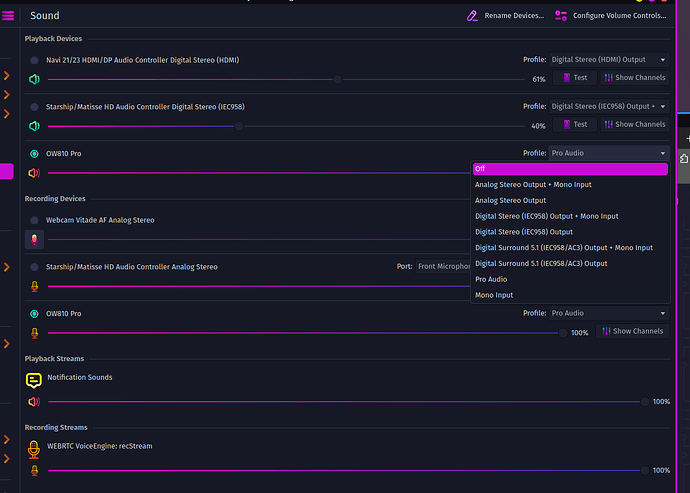

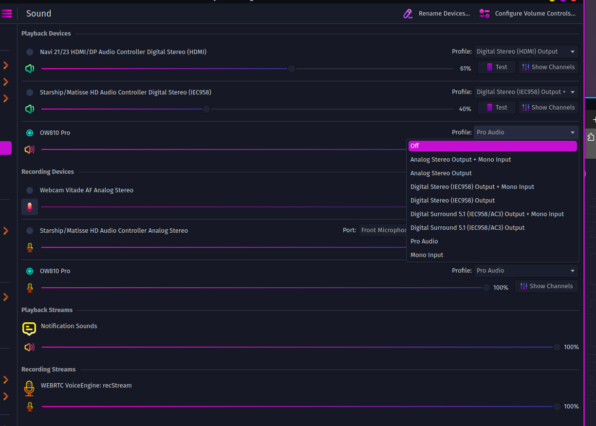

I have suddenly started having an issue with my wireless headset. When I turn on my headset I start getting an excruciatingly loud static type noise that won’t stop until I turn off the headset. Now I know that obviously sounds like a headset issue but actually it works fine in Windows still.
The headset is this one: Headset I am using it over the 2.4ghz band with the USB adapter.
It has been working fine since I installed Garuda around 2 or 3 months ago. The reason I think it might be an update is I was using Windows exclusively for a week or so because of a game so then when I switched back to Garuda of course there loads of updates that I immediately did.
What I have tried so far:
  • Switch from zen to lts kernel
  • Roll back with snapper to a snapshot from before the recent updates

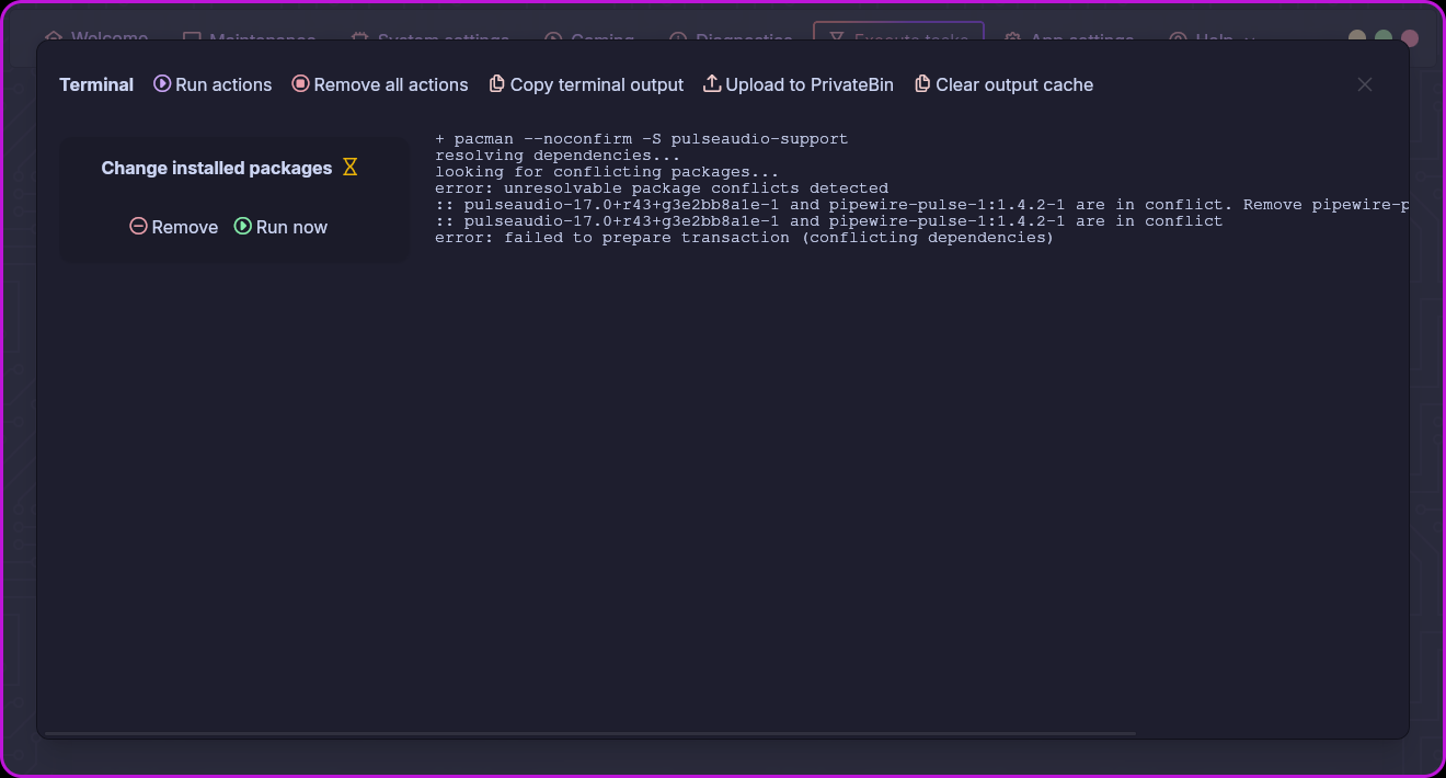

  • Uninstall pipewire & install pulse audio:
    Strange one this runs into a conflict with pipewire even though I have uninstalled it:
    I don’t really understand these different audio packages so I haven’t gone any further here yet.
  • Connected the headset via bluetooth: it is working for audio out but without stereo surround and the microphone is a lot weaker
Anyone have any fixes or suggestions?
Thanks in advance.

I think kernel 6.14.3/4 has some issues with audio at the least I’ve had the crackles and pops and use a widget (pipewire settings) to mitigate it for a time. you can also set up this here Pipewire audio crackling/popping fix no longer works after KDE 6 - #2 by Thee_Sly_Guy so pipewire isn’t always cutting audio off. i cant say it will help on bluetooth though or the mic.
I’ve had plenty of strange audio problems with Garuda since i started using it back around Feb/Mar 2025 (almost embarrassed to admit my first real Linux experience after 25 years of windows PC gaming, mainly online). Eventually i started fixing things with
alsamixer
in the terminal; have you played around with stuff in there? mute/unmute, test volume changes etc while playing sounds to make sure it’s not incorrectly labeling some in/out?
but i also am getting some crackling/pop/delay/drops lately that seem to have got worse. Hopefully i’ll be able to focus on it now that it seems like it might be a new cause of DotA 2 problems for me, and i’ll fix it with some sound driver/setting fiddling.
(i’ve just reinstalled Garuda for maybe the 5th time, always on XFCE for my aging hardware, and while i consider other distro, and tried XUbuntu for sake of hopefully improving Dota 2 performance, i really love Garuda and wow it’s way better than Ubuntu, so i keep fighting and reading and learning Arch :D))
I followed the steps from the wiki in the link you posted but when it got to restarting the pipewire and wireplumber services they were not found. This lead me to Rani & reinstalling pipewire there.(This is somewhere I think Garuda could improve, especially for new users, sure Rani is a helpful tool but it doesn’t actually give any help or guidance as to what the competing tools are) Decided this time to install also as @Dracosophy mentioned trying alsamixer. Low & behold I have working audio again, at least somewhat. It’s working fine with the stereo options except Surround 5.1, which still has the same crackling loud noise.
I’m going to continue to try & fix surround sound if I can but least I have got functional audio back again.
What is the pipewire settings widget you talked about? I haven’t been able to find it in octopi.
I tried alsamixer but I feel it doesn’t offer me much more than the normal GUI volume mixer provides. Perhaps I’m just not getting it.
Anyway thanks for the alsa suggestion as that appears to have set me on the path to a solution!
All you really needed to do with this config was in /usr/share/wireplumber/wireplumber.conf.d/ make a file called 51-disable-suspension.conf
 monitor.alsa.rules = [
    matches = [
        # Matches all sources
        node.name = "~alsa_input.*"
        # Matches all sinks
        node.name = "~alsa_output.*"
    actions = {
      update-props = {
        session.suspend-timeout-seconds = 0
# bluetooth devices
monitor.bluez.rules = [
    matches = [
        node.name = "~bluez_input.*"
        # Matches all sinks
        node.name = "~bluez_output.*"
    actions = {
      update-props = {
And save it.
It shouldn’t break your audio. if your set up is a bit diffren you might need the second step on the arch wikihere.
Some devices implement their own detection of silence and suspension. For them disabling node suspention alone won’t work. It’s possible to work around them by adding a small amount of noise, making it so the output never goes fully silent:
.../51-disable-suspension.conf
    session.suspend-timeout-seconds = 0,  # 0 disables suspend
    dither.method = "wannamaker3", # add dither of desired shape
    dither.noise = 2, # add additional bits of noise
the pipewire widget is Pipewire Settings - pling.com
I have implemented that in the usr folder. Let’s see how it goes.
One question, how did you know the correct folder path? The Arch wiki was pointing me towards /etc/wireplumber/wireplumber.conf.d/51-disable-suspension.conf or ~/.config/wireplumber/wireplumber.conf.d/ but the path you had was the correct one.
In this here
These Lua “configuration” scripts were then looked up in the standard configuration directories (/usr/share/wireplumber, /etc/wireplumber and ~/.config/wireplumber). The system also supported fragments of these scripts to be placed in directories called main.lua.d, policy.lua.d and bluetooth.lua.d respectively, in the same locations.
At that time it wasn’t working in the other areas for me. It was trial and error. and has worked for me since on multiple installs from arch to nix. Lua was ending at that time for the new format so just put it in the correct place
