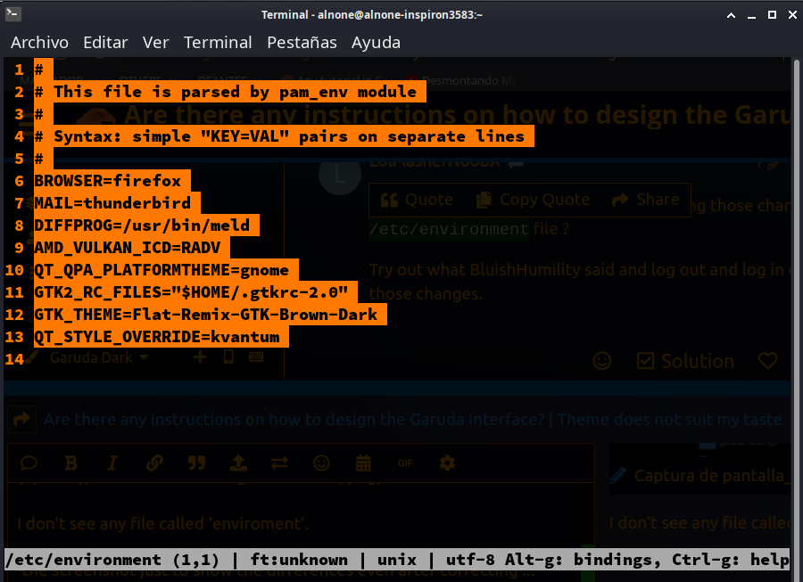

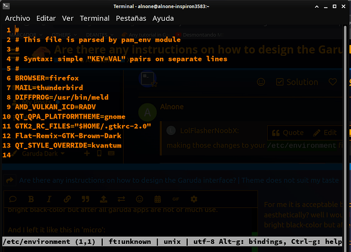

This looks right, except you guys have a space in there by accident, and also I would follow the exact letter casing of the filename, like this:
GTK_THEME=Flat-Remix-GTK-Brown-Dark
Well I did it as you said:
GTK_THEME=Flat-remix-GTK- Brown-Dark
but do not work, it changed all the previous configuration I had in xfce4, leaving it to pale, so I removed the ā€˜GTK_THEME=’ to:
and this ā€œworksā€, I say so because it does indeed change most of the applications to a dark/black tone, but not like the bright and very well defined xfce4 ones I have; it looks like if this kvantum overwrite was forcing it …
In case I did not explain muysefl very well, now the Xfce4 applications are perfect, sharp, with a bright dark color, but the garuda apps and some others although dark, do not have that contrast of the clear dark that have the Xfce4 ones. – I can’t post screenshots.
Did you log out and log in once after making those changes to your /etc/environment file ?
Try out what BluishHumility said and log out and log in once after making those changes.

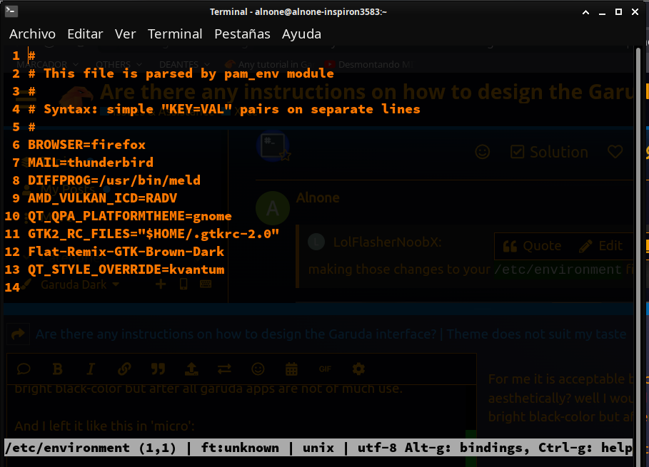

This one has a space in it again, so will not work.
This will not have any effect in /etc/environment because you are not setting an environment variable. You can remove the line altogether and it will be just the same. If this is ā€œworkingā€, it is because of one of your other unrelated efforts like nwg-look.
:man_shrugging: You should be able to. Have you tried? What it the error you are getting?

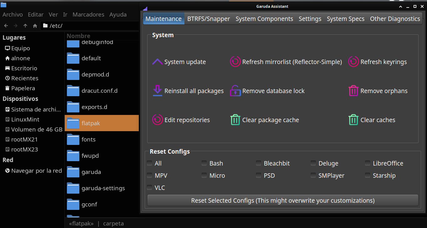

-the screenshot just to show the differences even after correcting …
Well you did edit the file so its good , now did you relogin after making these changes ?
yes, of course, many times even turn off …
To test … I went back to remove the first part ā€˜GTK_THEME=’, and it looks much better (?).

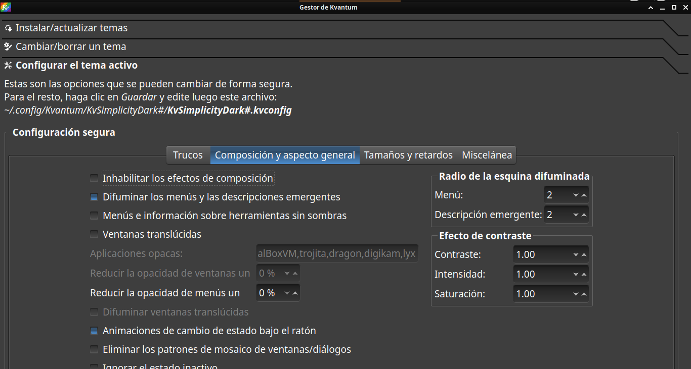

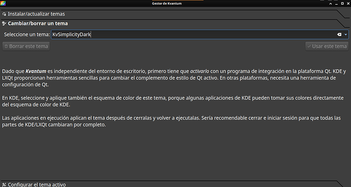

Could you please post a screenshot of your kvantum configuration + any garuda app which has broken theming ?
But no pictures from text files. You can copy and paste from micro too.
I’m not sure if I understand you, so please, tell me if this is what you need to see:
Could you please change the language to English ? Also please send the screenshots of the kvantum configuration that you use along with a separate screenshot of a app having a broken theme.
I was trying to change to english the app into the terminal but sudo LANG=C kvantum do not work.

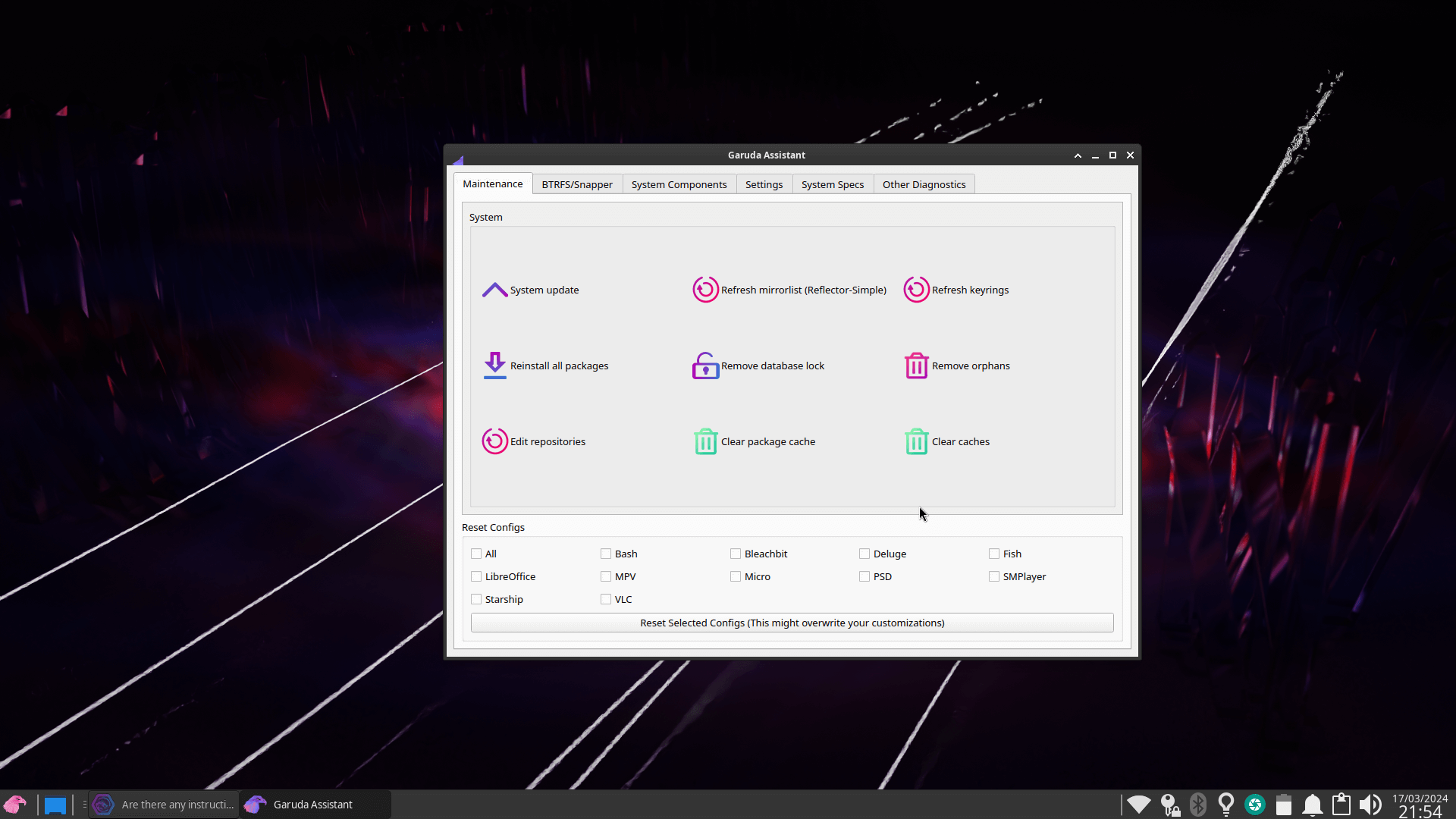

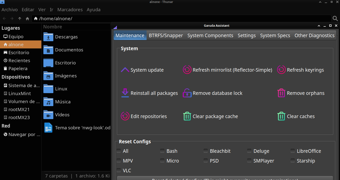

No my friend I’m nobody to say if something is broken o no, may is not I just can say that it looks different, the background black color in Xfce4 is bright crisp but in garuda is pale, I don’t know if you can see it in this screenshot:
en garuda only the frame is bright, like xfce4 app.
Yes I get it but did you fix it or not ?
I really don’t understand the question.
This is what it looks like now, it’s fixed?.
For me it is acceptable because the main thing was the vision issue, aesthetically? well I would like to see everything matched in the same bright black-color but after all garuda apps are not of much use.
And I left it like this in ā€˜micro’:

That’s the Kvantum theming and it looks fine to me. It doesn’t colour the same as Xfce stuff. I’m currently setting up another laptop and here’s my Garuda assistant with no theming…
…yuk.
I understand some people will like it this way, especially if they do not have vision problems but others we favor the contrast, the clear dark, especially dark backgrounds, very good when you have these problems …
– the aesthetic factor is of second term, although, I repeat myself, I would like that the garuda/apps imitate those of Xfce4!

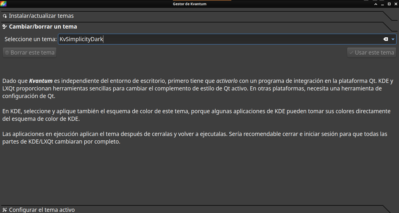

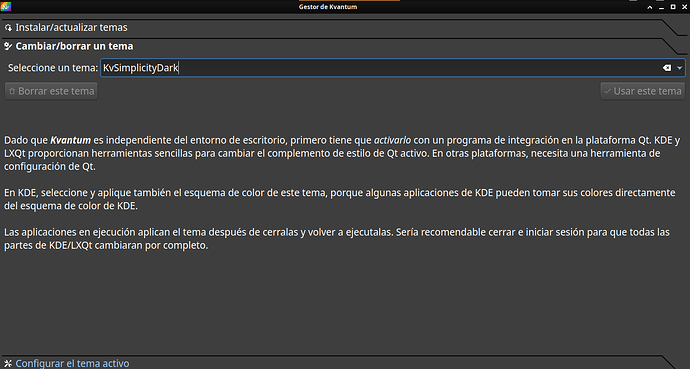

I think you should try some different Kvantum themes. Some of them are much darker.
On this screen here:
In that drop-down menu, choose another theme and click Usar este tema to see how it looks. Keep at it and you are bound to find one you like.
