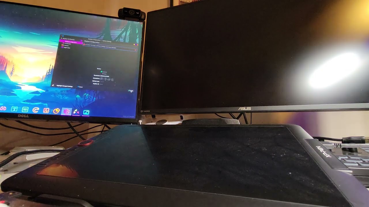

I was foolish enough to try another garuda-update and my monitor started doing funky things again, literally the same thing as before.
Described a little better, it goes like this. I reboot on either zen or lts kernel, and i'm presented with the login screen on both monitors. I login, and immediately the ASUS monitor (my primary) reads No Signal regardless of if i'm using HDMI or DisplayPort. I go into Display Settings and try to activate it. It doesn't read an input.
What I did last time to fix it is not working.
Last edit:
works with HDMI alone, does not work with both HDMI and DP plugged in. DP alone also does not work. I'd like to use the monitor with DP because it's the only input that does 165hz.
