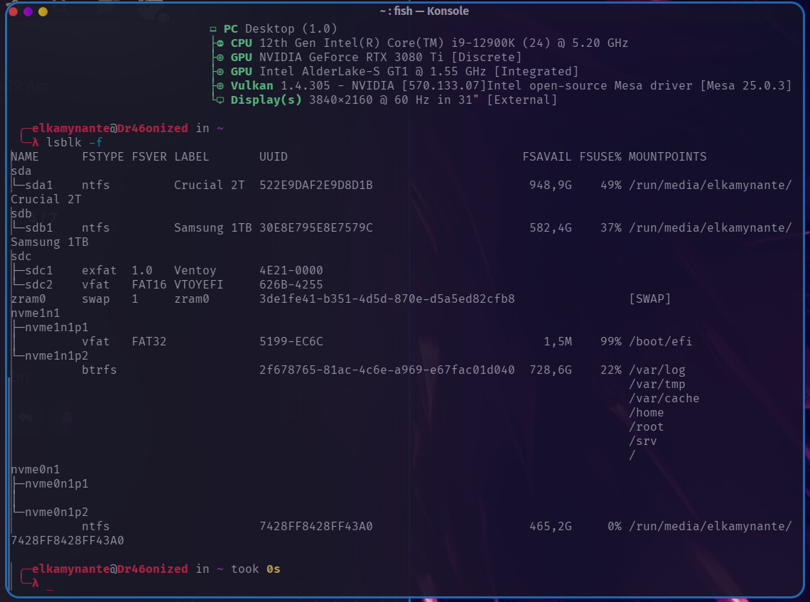

Hello! Few times asking help in forum I was advised to update my BIOS. The MSI manufacturer specify thou to not update the BIOS if everything goes fine and no bios issue it’s seen. But being new in Linux and 2-3 users told me few times to do it, I was thinking maybe they are right, so I did updated my BIOS. Right away on the first reboot after update I can’t anymore boot into Garuda. For enter into my system I have to use the USB Live stick and lose various minutes to go through all installation options for finally achieve to start Garuda.
I installed Garuda on a separated SSD, having Windows 10 also on other ssd. Few days ago I tried to update Windows and all was broken. I tried many options after read lot of tutorials but was not possible recover Wndows 10 neither to update it, neither to use anymore that SSD. The ssd appears on my disks manager but I can’t use in any way. So, I used only Garuda since that day and installed Windows on QEMU Virtual Machine for being able to use some software in Windows needed for my work. Abd everything was just fine…until I updated the BIOS!
Because after updating the BIOS, now I have another big problem added to the loose of Windows and its SSD. Now I have beside an unusable 500GB SSD, an “un-bootable” Garuda system. Which worked perfect before the BIOS update!
Here the inxi file if someone can help me solve some of these issues. Thanks in advance!

Local Storage: total: 4.11 TiB used: 1.43 TiB (34.8%)
ID-1: /dev/nvme0n1 maj-min: 259:3 vendor: Crucial model: CT500P3PSSD8 size: 465.76 GiB
fw-rev: P9CR413 temp: 45.9 C scheme: GPT
ID-2: /dev/nvme1n1 maj-min: 259:0 vendor: Western Digital model: WDS100T1X0E-00AFY0
serial: <filter> fw-rev: 614900WD temp: 45.9 C scheme: GPT
ID-3: /dev/sda maj-min: 8:0 vendor: Crucial model: CT2000MX500SSD1 size: 1.82 TiB block-size:
physical: 512 B logical: 512 B speed: 6.0 Gb/s tech: SSD serial: <filter> fw-rev: 043 scheme: GPT
ID-4: /dev/sdb maj-min: 8:16 vendor: Samsung model: SSD 870 QVO 1TB size: 931.51 GiB
fw-rev: 2B6Q scheme: GPT
ID-5: /dev/sdc maj-min: 8:32 vendor: Kingston model: DataTraveler 3.0 size: 14.44 GiB
block-size: physical: 512 B logical: 512 B type: USB rev: 3.1 spd: 5 Gb/s lanes: 1
mode: 3.2 gen-1x1 tech: N/A serial: <filter> fw-rev: PMAP scheme: MBR
ID-1: / raw-size: 931.22 GiB size: 931.22 GiB (100.00%) used: 201.81 GiB (21.7%) fs: btrfs
dev: /dev/nvme1n1p2 maj-min: 259:2
ID-2: /boot/efi raw-size: 300 MiB size: 299.4 MiB (99.80%) used: 297.9 MiB (99.5%) fs: vfat
dev: /dev/nvme1n1p1 maj-min: 259:1
ID-3: /home raw-size: 931.22 GiB size: 931.22 GiB (100.00%) used: 201.81 GiB (21.7%) fs: btrfs
ID-4: /var/log raw-size: 931.22 GiB size: 931.22 GiB (100.00%) used: 201.81 GiB (21.7%)
ID-5: /var/tmp raw-size: 931.22 GiB size: 931.22 GiB (100.00%) used: 201.81 GiB (21.7%)
