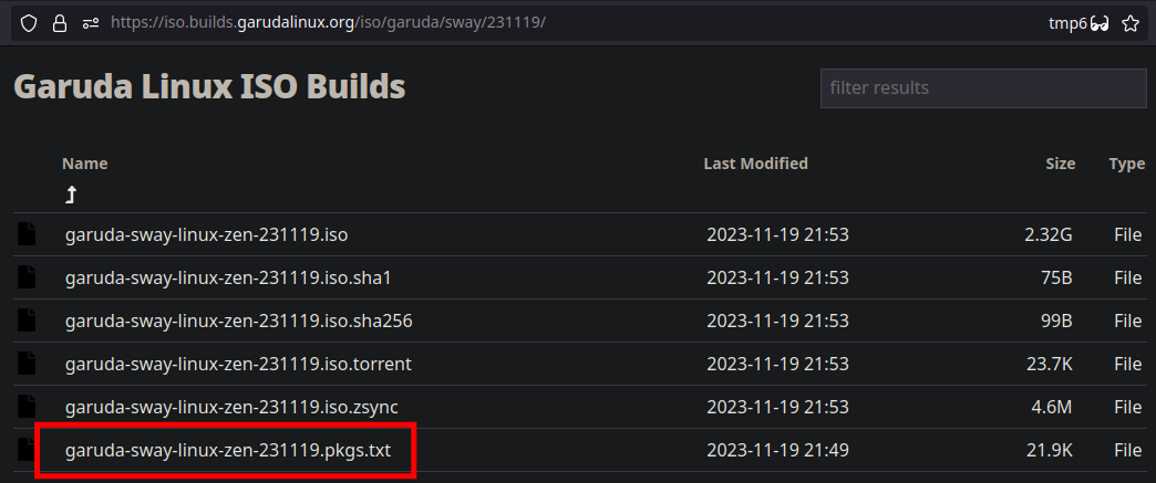

Every ISO has a text file with a list of packages it will install. You could pacstrap off of that if you wanted to.
This distro is not just a wad of packages though. There is a ton of configuration that gets set up during the installation routine. It is highly advised to use the installer.
