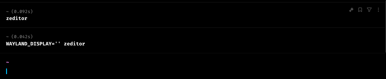

Issue -
Zed does not open under wayland
Fixes tried -
Launched with WAYLAND_DISPLAY='' variable as suggested by zed wiki
Garuda using amd-radeon instead of amdvlk by default as suggested by zed wiki
Tried using the zed-git package, using installation script provided on zed website, using the tarball provided on zed website, same issue with all
important details -
Using nvidia geforce gtx 1650, driver - 560.35.03
using envycontrol on hybrid mode
had issues with launching wayland on gdm, had to use ln -s /dev/null /etc/udev/rules.d/61-gdm.rules as per the arch wiki to enable wayland

Run, zed through terminal and give us the logs

there are no crash logs, it simply does not open, using the zed package from extra repo of arch
what if sudo zeditor? do logs appear
Zed is in the early stages of Linux from what I know. Possibly a not-implemented feature yet?
doing sudo zeditor actually opened zed :exploding_head: but its not really working, I can’t scroll up or down or paste my Gen AI API keys, I can type though. No logs appear on terminal though.
it was working absolutely fine and out of the box on my previous base arch installation on wayland, same nvidia setup. I tried on Fedora wayland too, no issues, I posted on r/zeditor as well and someone else is facing the same issue too on garuda, so it makes me believe it has to do something with garuda.
That’s indeed an indicator, true.
Makes me wonder whether there is some configuration error somewhere,
…what i would do?
  • How about you purge anything to do with zeditor (including configs/all or anything)
  • Install zeditor through flatpak
  • Now using flatpak command how about switching the theme for this particuar app fonts and all.
okay so, flatpak didn’t work either but someone on reddit suggested a solution that worked, using -
env -u WAYLAND_DISPLAY zeditor
worked
while WAYLAND_DISPLAY='' zeditor doesn’t work, I am not sure why but for now this is the best workaround I found.
Thanks a lot for everyone’s help here!
