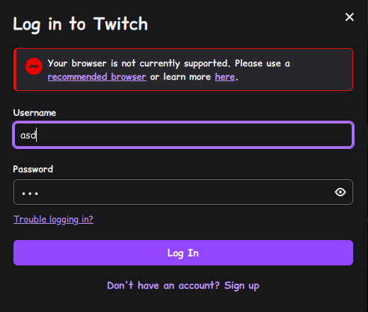

"Your browser is not currently supported." when logging into Twitch on Firedragon
Hello! Searched everywhere, there was an old suggestion to add twitch to privacy.resistFingerprinting.exemptedDomains, but it doesn’t work anymore. A week ago I was able to login on a private tab, but now it refuses to do it even there. I removed all the extensions from private and it still didn’t work.
Any suggestions?

Twitch will complain even if you input random garbage on the text fields and press enter. It seems like Amazon just doesn’t like Firedragon.

I think this has to do with the FireDragon user agent pretending to be on Windows.
Can you please try setting general.useragent.override to Mozilla/5.0 (X11; Linux x86_64; rv:128.0) Gecko/20100101 Firefox/128.0 in about:config?
Might require clearing the cookies and site data for Twitch.

Just changing the useragent and restarting Firedragon does work. I think I’ll still keep on Floorp for easy access to two windows on boot until you maybe (or maybe not, I’m not a FD dev) implement multiwindow profiles that work flawlessly :3

You’re a genius. I tried to set it to linux with extension but it didn’t work, but doing it manually worked. Thanks.
