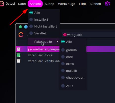

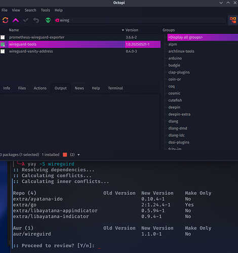

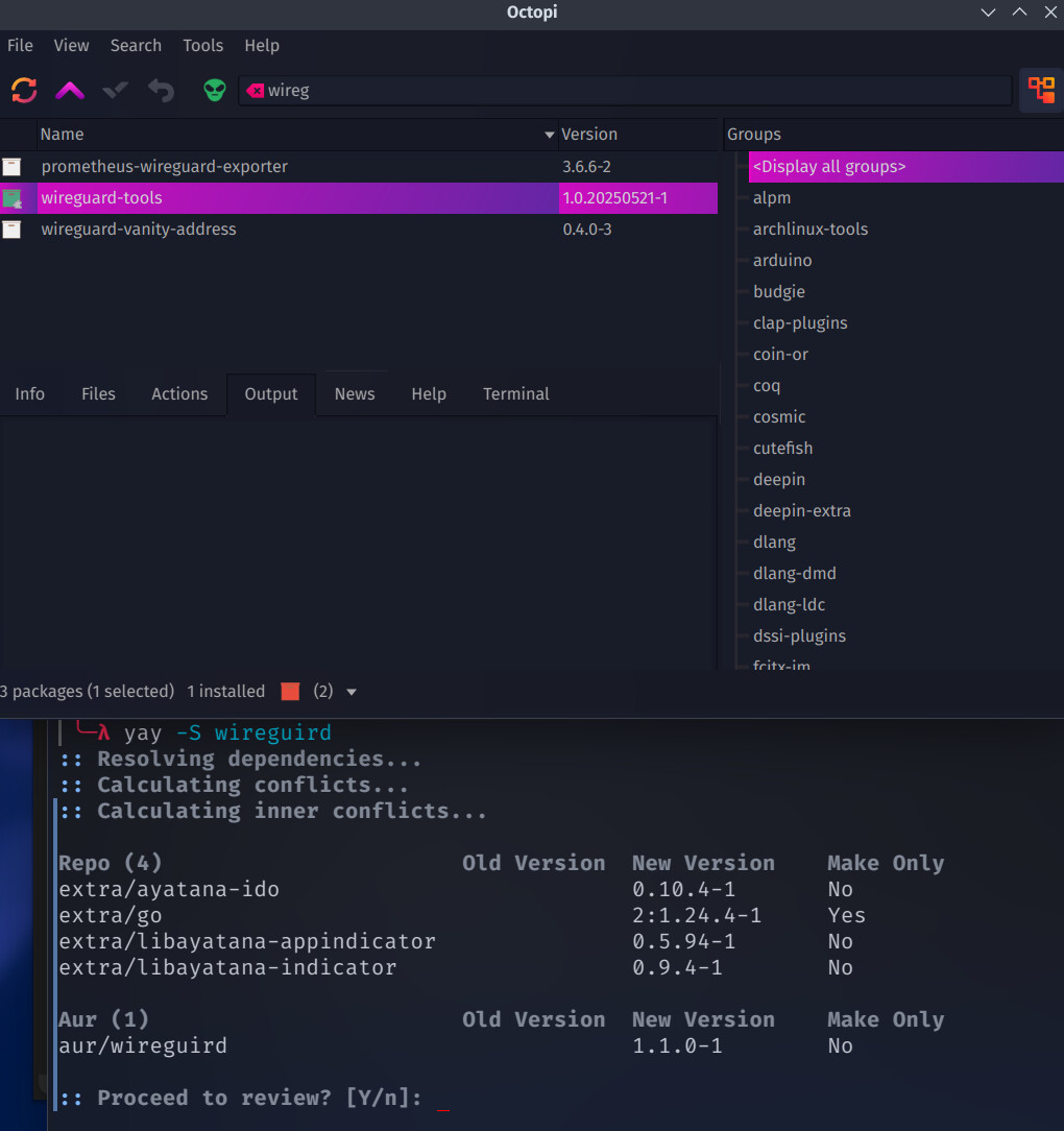

Now, can someone please explain why things that I know for a fact are in the AUR don’t show up in Octopi? Yes, I am updated. Heres just one example:

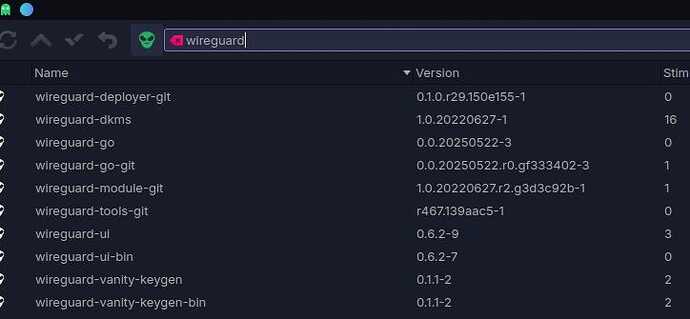

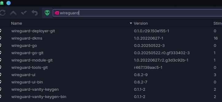

Pls click on the green button “alien”…then you see the aur packages if you insert a package name.
And take a look in the settings from octopi → default is “all”
Last but not least, as already mentioned 100 times in the forum, do not use a GUI to install packages, only to search for them.
