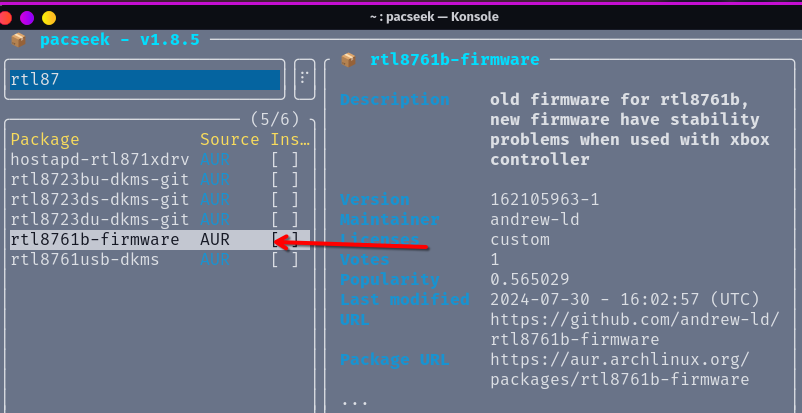

hi again,
after a little research to your used Hardware :ok_hand:
Device-1: TP-Link UB500 Adapter driver: btusb v: 0.8 type: USB rev: 1.1
    speed: 12 Mb/s lanes: 1 mode: 1.1 bus-ID: 1-10:9 chip-ID: 2357:0604
  Report: btmgmt ID: hci0 rfk-id: 2 state: up address: <filter> bt-v: 5.1
    lmp-v: 10 status: discoverable: no pairing: no
If its based on the Realtek 8761b chipset maybe you try the older Firmware for it.
i dont know if you have fixed Paru ! over paru if not may the git clone way just tell if its not working.
paru -S rtl8761b-firmware
on Review it type “Y” then to quite it “q” and to install “Y” again.Ater the install Close it and reboot . Share a new garuda-inxi if its in use for it.
Thank you very much. That solution solved the problem. I’m even embarrassed, because I have five years of experience as a Linux system administrator and work in hosting. And I didn’t even think to look here.
Thank you, I’ve been playing for four hours now. And not a single connection drop :slight_smile:
