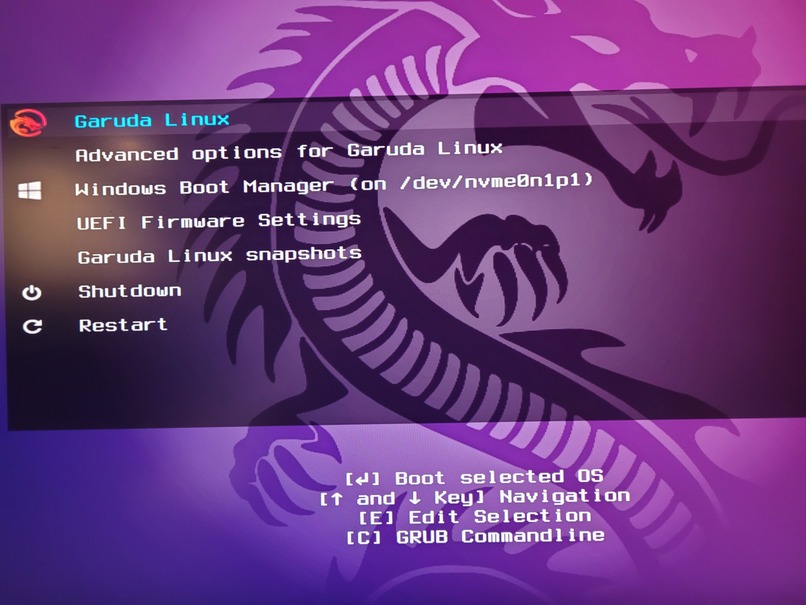

ok one more thing. my bios now recognizes nvme0n1p1 as garuda but grub still thinks that windows boot manager is on nvme0n1. is this actually normal or should it be saying that it is on sda?

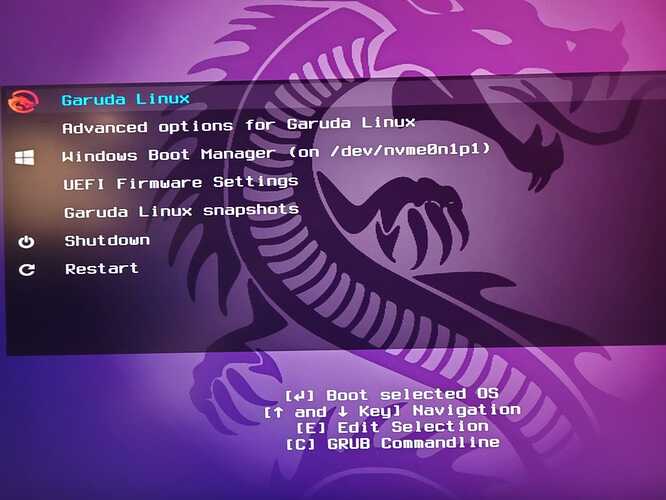

I already did sudo update grub. here is an image of my grub
I know for fact I installed windows on sda
