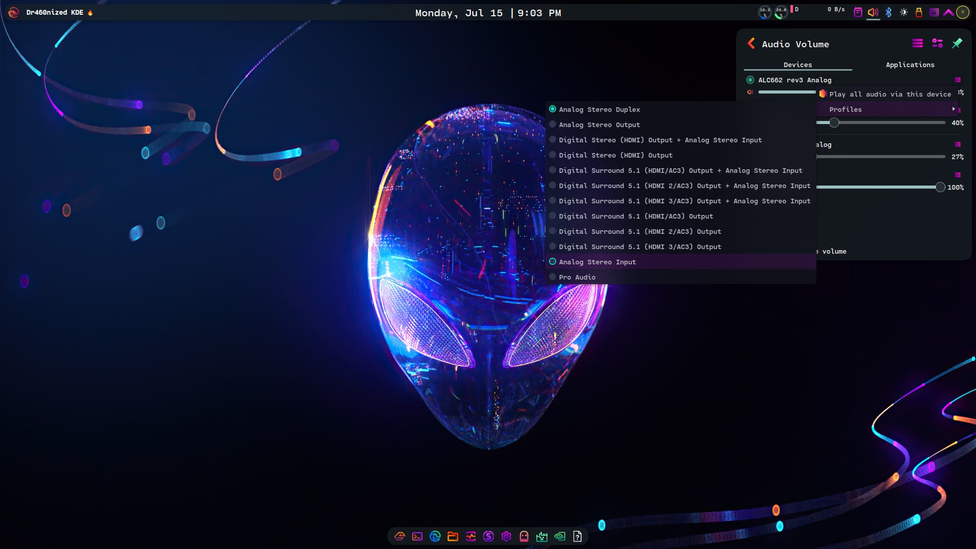

Recently, I installed droidcam and suddenly, I have 12 audio profiles instead of the 5 U had before it. For reference,
I now have these many, but earlier, I had only the first 4 and the last one. Why is that and is there a way to remove these and get back to what it was earlier?

I only have 2 sinks. One was the loopback which was causing some old problem. Other one is the active audio output device but it doesn’t list all the profiles within that device and just shows only the active profile within that. If I have chosen my headphones to be output, it shows the corresponding name and if I choose the monitor speakers as output, the sink name changes accordingly to HDMI output, etc.
