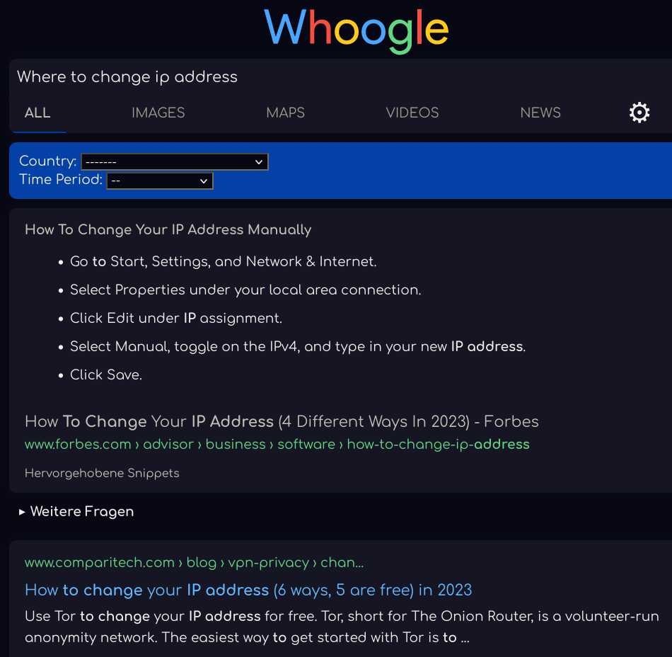

In the template is even how to learn to search correctly.
