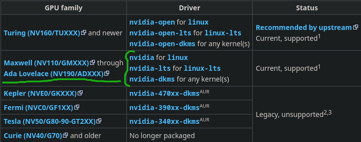

Ever since I removed the nvidia drivers in my last troubleshooting session my battery has been so weak to the point of only getting 3 hours out of a 100% charge. I tried putting the nvidia drivers back in but doing that caused problems so I removed them. I tried working with cpupower, and powertop but those didn’t help much. When I had the nvidia drivers in it caused my shutdown time to hang at a stop job on simple desktop display manager and would take up to 2 or 3 minutes. That stopped once I removed it but then I put TLP in for power and boosted my battery to 6 hours from 100% but now I’m hanging at my shutdown phase again and even when I restart after an update hangs at the powering down phase ):
