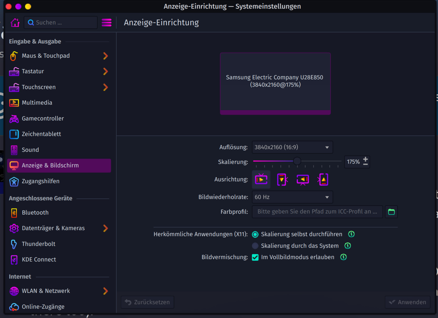

about the waylad is not there thing:
year it is causing as much problems as it solves at the Moment
but it is fine for me
Right, it might be HDMI, but i would have to use a Displayport to HDMI converter for my current setup to work.
Right now i have a HDMI splitter that splits to my TV and my display so i can play in my bed. So i wold have to use a converter for that (I don’t have one right now but i will try it soon, have to bye a converter for that).
No update?
well that ads a lot of points of failure
try a direct connection and see if it works that way
with HDMI and with DP and try to avoid converters for the test, just ads another point of failure.
