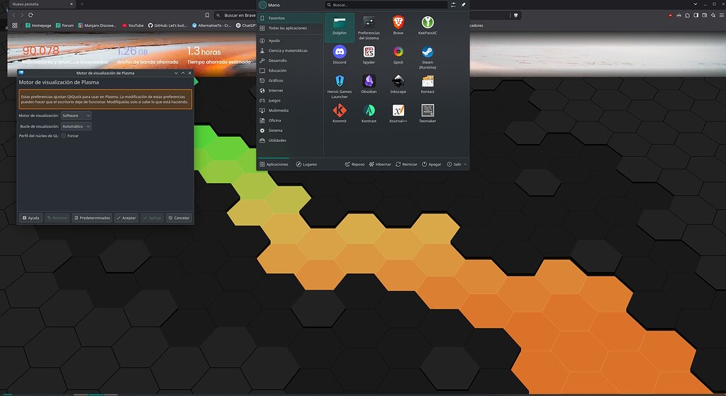

Now a :light_bulb: is dawning on me. Possibly plasma falls back to “software rendering mode” (that would fit your error picture).
If you ever switch back to KDE and the issue occurs again, open ~/.config/kdeglobals and check if this entry is there:
[QtQuickRendererSettings]
SceneGraphBackend=software
If yes, simply delete both lines. :slight_smile:
I am facing the same issue on my system (lag + heating), everything on htop looks normal. Nothing running heavy just vscode and on x11 there is no such issues. btw i checked if I have SceneGraphBackend but I dont in kdeglobals
