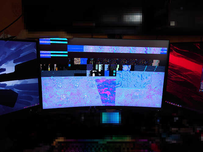

Hello,
I’m having a pretty significant problem with Wayland on KDE plasma - I have two GPUs, in PCIe slots 1 (“GPU1”) and 2 (“GPU2”), and 3 displays connected to them, two (“sides”) to the GPU1 and third (“main”/“primary”/“center”) to GPU2. The displays connected to GPU1 work fine, but the one connected to the GPU2 some time ago was showing a black screen, but now it usually looks like some sort of graphical memory dump (different on every session). The windows that are supposed to be on that screen do work, and can be moved around and/or interacted with. The fact that I can actually move cursor over that glitchy mess (and it reacts to the windows that are supposed to appear there) makes it quite cursed.
(I was actually playing Beyond All Reason on Windows, and you can see some game stuff in the glitches)
However the displays work (mostly) fine with X11 session.
Something I found that might be useful, with boot process - I managed to configure my BIOS to turn on one of the displays connected to the each of the GPUs. However, the GPU that has the display with grub is then the one that works in the OS. Between grub and log-in, the displays connected to that GPU (usually GPU1) work fine, while the other one(s) turn on, but only show graphical glitches or remain black. At login screen, the ones connected to the working GPU show login screen, but other(s) turn off. They come back after logon, but, with Wayland, they show the glitchy mess, while on X11, they work fine. I tried reinstalling the drivers in the garuda settings hardware manager (and force-reinstalled explicitly with mhwd), but this seems to have had zero effect on anything.
Found this on this forums:
And this seems to be the exact issue I’m having, but the “solution” is apparently wrong?..:
Right now I am confused… Am I just waiting for the “wayland now works with multiple GPUs” update, or are my drivers busted, or do I have to load some module early in the initramfs (how? (attempt at using dracut (after finding out that Garuda is not using mkinitcpio) failed)), or some other problem?..
Part of the reason for posting this is just to make some more noise about this problem, but ideally… Is there a solution, that isn’t basically “just use X11”? I am getting choppy movement on X11 that is quite the eyesore, while the buttery smoothness of Wayland at 120Hz is mesmerizing, even when just dragging windows around.

I know you may not wish to do this but, login to a x11 session at the login screen to see if it works
I said in my post, that they do technically work with X11.
That was my point use just use x11
Edit
I have a system that will not work under wayland but does on x11, so i just use x11 :smiley:
I would suggest to test the VRAM on GPU2 to rule out hardware issues. Under certain loads, VRAM issues can become more apparent. There is a memtest that uses vulkan in the AUR that might help you:
AUR (en) - memtest_vulkan-git
Thanks for the tip - I tested both GPUs for a bit over 5 minutes, it says it passed for both of them. So probably not that…
…I don’t have to give the tool any special options to test what I had to test, right?..
A bit over 5 minutes should do it as it says to run the test for at least 6 minutes, at that point you can stop the test with CTRL+C keys. It also doesn’t require parameters or configuration, so you should be set with the test.
I haven’t used multiple GPUs in one machine in Linux, so sadly I can’t provide any first hand experience using a Wayland session with that kind of setup. I’ll try searching around some issue trackers to see what I find.
Try setting early module loading by setting up a dracut config, as described here:
https://wiki.archlinux.org/title/Dracut#Early_kernel_module_loading
Create a config in /etc/dracut.conf.d.
sudo micro /etc/dracut.conf.d/nvidia.conf
Add the Nvidia modules to the config with force_drivers+=.
force_drivers+=" nvidia nvidia_modeset nvidia_uvm nvidia_drm "
After setting up the config, rebuild the initramfs.
sudo dracut-rebuild
It may also be worth testing other kernels, for example the LTS kernel.
This didn’t work… I hope that the fact that I edited a file named add_nvidia_drivers.conf in kate, rather than nvidia.conf in micro doesn’t matter. :sweat_smile:
Getting the same effect with zen and lts kernels.
It sounds like you are seeing artifacts lingering from your Windows session, is that right? Be sure to disable the “fast startup” feature in Windows, as it can hold on to unexpected resources when Windows is supposedly “off”. What Is “Fast Startup” Mode and How to Enable or Disable It? - MiniTool
One other thing you could try would be to set the nvidia_drm.fbdev=1 kernel parameter.
https://wiki.archlinux.org/title/NVIDIA#DRM_kernel_mode_setting
Additionally, with the driver version 545 and above, you can also set the experimental nvidia_drm.fbdev=1 parameter, which is required to tell the NVIDIA driver to provide its own framebuffer device instead of relying on efifb or vesafb, which do not work under simpledrm.
If neither of those take the curse off, this may be your best bet:
It looks like there is a regression or few with the latest Nvidia drivers breaking Plasma Wayland. I have seen a few issues regarding this here and there, for example this topic from another forum:
It could be your issue is related to that, and not something which can be remedied with some adjustments to your configuration.
Fast startup is already off, but in that instance, windows had BSOD’d. Nonetheless, I would guess that, if the GPU doesn’t get its power cut, then its RAM chips retain some info that the OS put there. TBH, it is some pretty cool stuff to look at, but I also wonder whether there are any potential cybersecurity concerns there…
Do I understand correctly that I have to add this to
/etc/default/grub
to the
GRUB_CMDLINE_LINUX_DEFAULT
and/or
GRUB_CMDLINE_LINUX
string, and then run
sudo update-grub
EDIT: if I do sudo more /sys/module/nvidia_drm/parameters/fbdev, it says Y
does this mean that I already have that thing enabled?..
EDIT2: I did that (but I ran sudo grub-mkconfig -o /boot/grub/grub.cfg), and there is no change, neither on zen nor lts kernel.
Addendum: I haven’t mentioned this yet, but the display that shows the glitches with Wayland, also turns off when I am on the login screen, regardless of whether I have just booted into it, or logged out.
