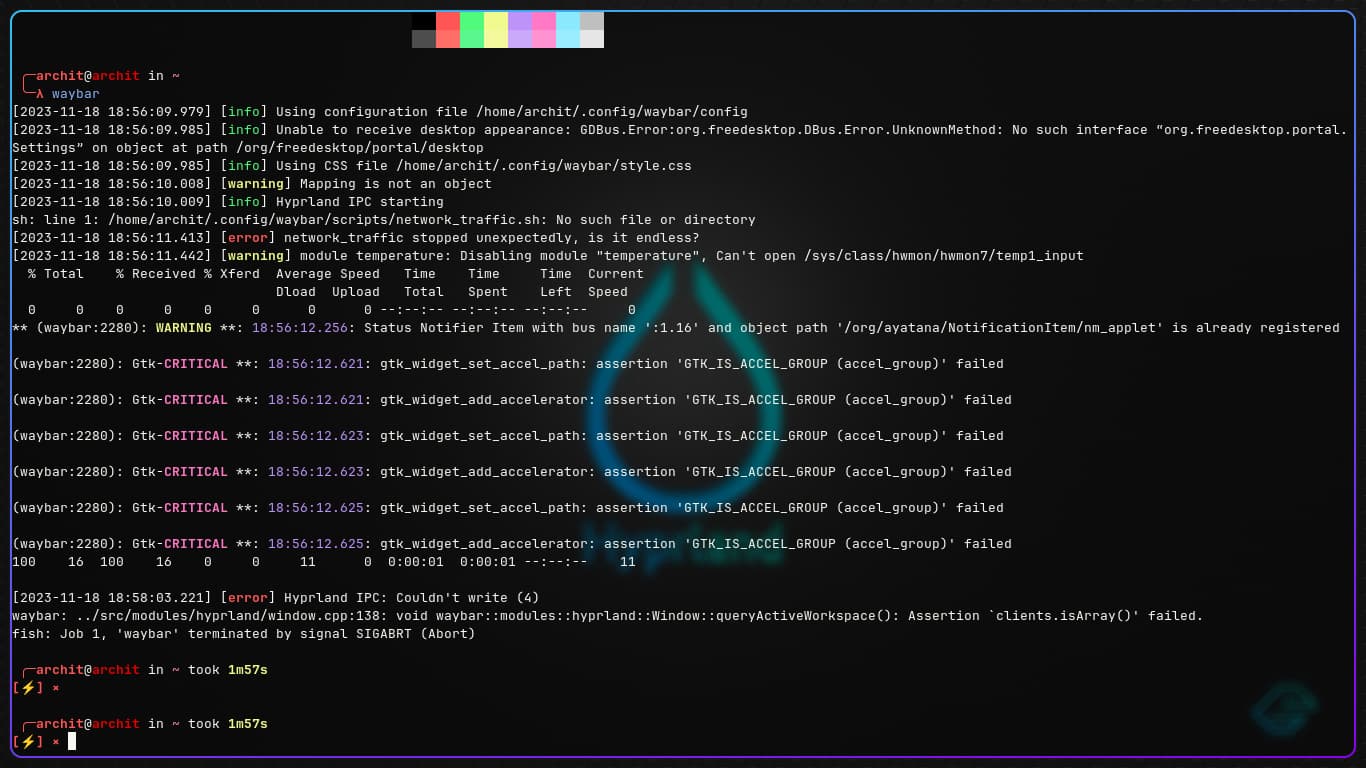

Hello everyone! :wave:
I’ve been a DE/WM hopper for a month now and I keep visiting Hyprland (randomly dual-boot it with KDE whenever I want). In these visitings of mine, I have noticed one issue. After Fresh installing Hyprland and configuring Waybar to my display size (1360, height=10, font size=10 or 12), after sometime the Waybar suddenly crashes and core dumps.
Sometimes it crashes when I launch Firefox. Sometimes it just crashes when the system is idle for like 5 - 10 mins. There is no pattern as such. At the time of writing this, I opened YouTube in Vivaldi (with Garuda Forum already open in one tab for quite some time) and the waybar crashed.
I’ve tried a lot of things suggested by @NaN (Thanks a lot for helping!) on Telegram like switching to waybar-git, waybar-experimental, also compared package lists with his to see if I’m missing some libs. Even reinstalled it today! Nothing has solved the issue :frowning_face:
Teriminal output after executing waybar:
waybar
[2023-11-18 17:05:52.464] [info] Using configuration file /home/archit/.config/waybar/config
[2023-11-18 17:05:52.469] [info] Unable to receive desktop appearance: GDBus.Error:org.freedesktop.DBus.Error.UnknownMethod: No such interface “org.freedesktop.portal.Settings” on object at path /org/freedesktop/portal/desktop
[2023-11-18 17:05:52.469] [info] Using CSS file /home/archit/.config/waybar/style.css
[2023-11-18 17:05:52.491] [warning] Mapping is not an object
[2023-11-18 17:05:52.495] [info] Hyprland IPC starting
[2023-11-18 17:05:53.786] [warning] module temperature: Disabling module "temperature", Can't open /sys/class/hwmon/hwmon7/temp1_input
  % Total    % Received % Xferd  Average Speed   Time    Time     Time  Current
                                 Dload  Upload   Total   Spent    Left  Speed
  0     0    0     0    0     0      0      0 --:--:-- --:--:-- --:--:--     0
** (waybar:18260): WARNING **: 17:05:54.648: Status Notifier Item with bus name ':1.53' and object path '/org/ayatana/NotificationItem/nm_applet' is already registered
(waybar:18260): Gtk-CRITICAL **: 17:05:54.722: gtk_widget_set_accel_path: assertion 'GTK_IS_ACCEL_GROUP (accel_group)' failed
(waybar:18260): Gtk-CRITICAL **: 17:05:54.722: gtk_widget_add_accelerator: assertion 'GTK_IS_ACCEL_GROUP (accel_group)' failed
(waybar:18260): Gtk-CRITICAL **: 17:05:54.724: gtk_widget_set_accel_path: assertion 'GTK_IS_ACCEL_GROUP (accel_group)' failed
(waybar:18260): Gtk-CRITICAL **: 17:05:54.725: gtk_widget_add_accelerator: assertion 'GTK_IS_ACCEL_GROUP (accel_group)' failed
(waybar:18260): Gtk-CRITICAL **: 17:05:54.727: gtk_widget_set_accel_path: assertion 'GTK_IS_ACCEL_GROUP (accel_group)' failed
(waybar:18260): Gtk-CRITICAL **: 17:05:54.728: gtk_widget_add_accelerator: assertion 'GTK_IS_ACCEL_GROUP (accel_group)' failed
100    16  100    16    0     0     10      0  0:00:01  0:00:01 --:--:--    10

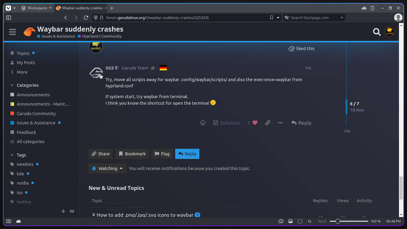

Try, move* all scripts away for waybar .config/waybar/scripts/ and also the exec-once=waybar from hyprland.conf
If system start, try waybar from terminal.
I think you know the shortcut for open the terminal :slight_smile:
  • Rename the dir :slight_smile:
Just after I moved the scripts… Waybar crash!
Yes, reboot.
Maybe one script let the waybar crash on your system.

Please, never post SS from terminal, copy, paste the text like you post the garuda-inxi, this is not telegram :slight_smile:

I’ll try and get the waybar crashed again and then paste the output!
:man_facepalming:
Here! (strangely satisfying):
 waybar
[2023-11-18 19:18:45.986] [info] Using configuration file /home/archit/.config/waybar/config
[2023-11-18 19:18:45.990] [info] Unable to receive desktop appearance: GDBus.Error:org.freedesktop.DBus.Error.UnknownMethod: No such interface “org.freedesktop.portal.Settings” on object at path /org/freedesktop/portal/desktop
[2023-11-18 19:18:45.990] [info] Using CSS file /home/archit/.config/waybar/style.css
[2023-11-18 19:18:46.005] [warning] Mapping is not an object
[2023-11-18 19:18:46.006] [info] Hyprland IPC starting
sh: line 1: /home/archit/.config/waybar/scripts/network_traffic.sh: No such file or directory
[2023-11-18 19:18:46.748] [error] network_traffic stopped unexpectedly, is it endless?
[2023-11-18 19:18:46.773] [warning] module temperature: Disabling module "temperature", Can't open /sys/class/hwmon/hwmon7/temp1_input
100    16  100    16    0     0     12      0  0:00:01  0:00:01 --:--:--    12
** (waybar:2135): WARNING **: 19:18:50.039: Status Notifier Item with bus name ':1.14' and object path '/org/ayatana/NotificationItem/nm_applet' is already registered
(waybar:2135): Gtk-CRITICAL **: 19:18:50.083: gtk_widget_set_accel_path: assertion 'GTK_IS_ACCEL_GROUP (accel_group)' failed
(waybar:2135): Gtk-CRITICAL **: 19:18:50.084: gtk_widget_add_accelerator: assertion 'GTK_IS_ACCEL_GROUP (accel_group)' failed
(waybar:2135): Gtk-CRITICAL **: 19:18:50.085: gtk_widget_set_accel_path: assertion 'GTK_IS_ACCEL_GROUP (accel_group)' failed
(waybar:2135): Gtk-CRITICAL **: 19:18:50.088: gtk_widget_add_accelerator: assertion 'GTK_IS_ACCEL_GROUP (accel_group)' failed
(waybar:2135): Gtk-CRITICAL **: 19:18:50.094: gtk_widget_set_accel_path: assertion 'GTK_IS_ACCEL_GROUP (accel_group)' failed
(waybar:2135): Gtk-CRITICAL **: 19:18:50.097: gtk_widget_add_accelerator: assertion 'GTK_IS_ACCEL_GROUP (accel_group)' failed
[2023-11-18 19:19:07.436] [error] Hyprland IPC: Couldn't write (4)
[2023-11-18 19:19:08.641] [error] Hyprland IPC: Couldn't write (4)
waybar: ../src/modules/hyprland/window.cpp:138: void waybar::modules::hyprland::Window::queryActiveWorkspace(): Assertion `clients.isArray()' failed.
fish: Job 1, 'waybar' terminated by signal SIGABRT (Abort)
