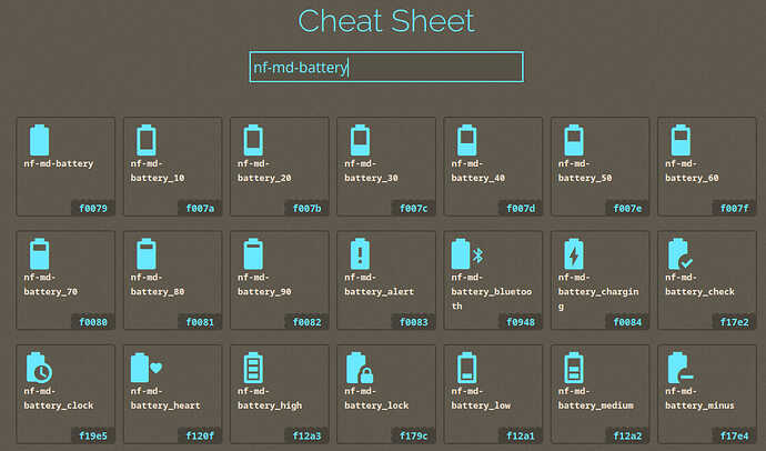

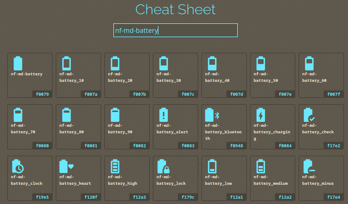

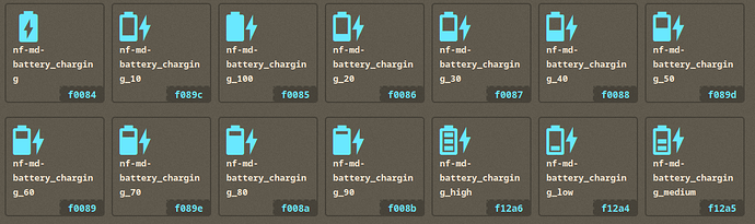

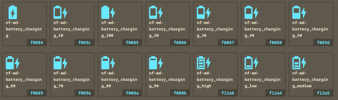

I don’t really love the idea of adding an extra icon next to the existing icon to show that it is charging, but I’m not super opposed to it either. If we were going to do that I would almost rather switch to another battery icon set like na-md-battery.
They have a separate series of icons for a charging state that add a little lightning bolt next to the battery. So you can have 10%, 20%, 30% and so on, and then the same if it is plugged in but with the lightning bolt next to it.

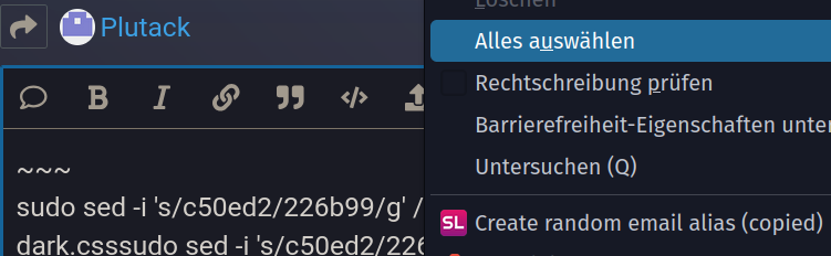

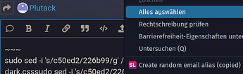

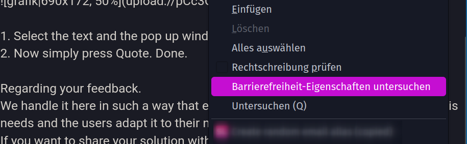

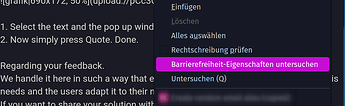

  1. Select the text and the pop up window appears.
  2. Now simply press Quote. Done.

What do you think about sticking the extra icon on the other side of the number? Battery icon > battery % > plug icon.

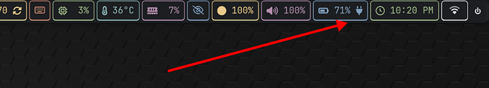

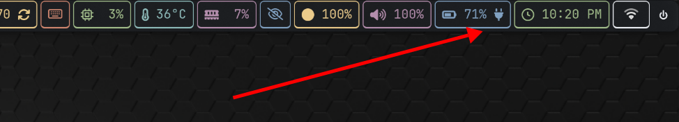

I finally put together some time to experiment with this, and ended up scrapping the style.css color-based differentiator and added a plug icon to indicate a “plugged” state instead.
I decided to keep it simple and just have the one icon for all three states (plugged, charging, full). Basically, if it’s plugged in it will get the plug. If anyone wants to take it further than that, the other states are already defined in the config now so users just need to add or change icons as they see fit.

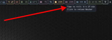

The tooltip will have a second line that mentions this new on-click action (“Click to reload Waybar”). This is kind of a bad screenshot but it looks like this:
