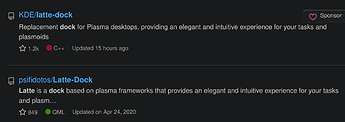

Latte-Dock
all i see is source code? they don't seem to even have a wiki... think i'll try linux again in the future, thanks anyway.
