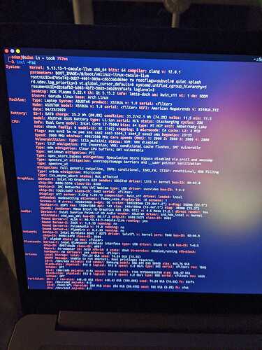

Okay so this is really weird, was using the laptop earlier today, but booting it up now it only shows the attached wallpaper. No dock and keys don't seem to work or anything. I restored old snapshots and same exact problem. I really have no clue why this happened or how to fix it. Please help me I'm worried now
Okay quick update because I'm dumb. Terminal shortcut does work so I do have access to that
