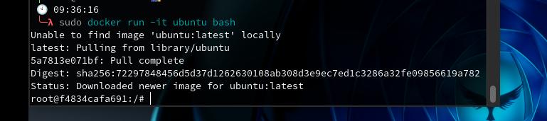

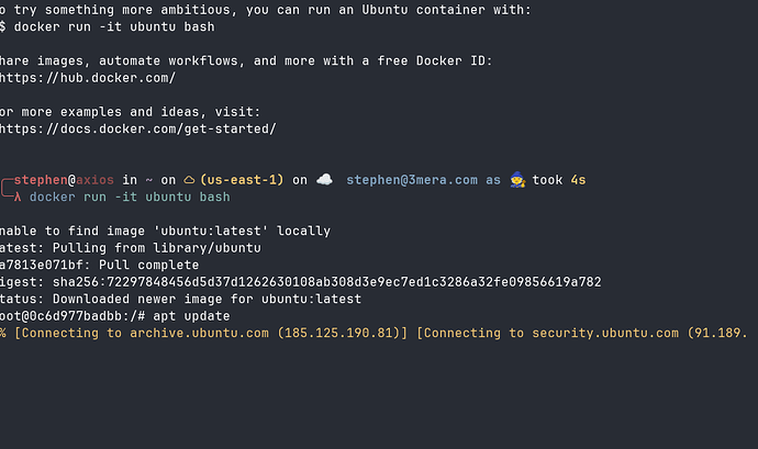

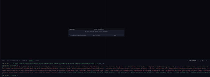

Steps taken:
i rebooted machine
restarteed docker
i checked my fowarding on host
╰─λ cat /proc/sys/net/ipv4/ip_forward
File: /proc/sys/net/ipv4/ip_forward
1

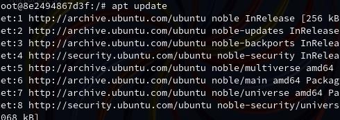

i ran these cmds
pkill docker
iptables -t nat -F
ifconfig docker0 down
brctl delbr docker0
systemctl restart docker

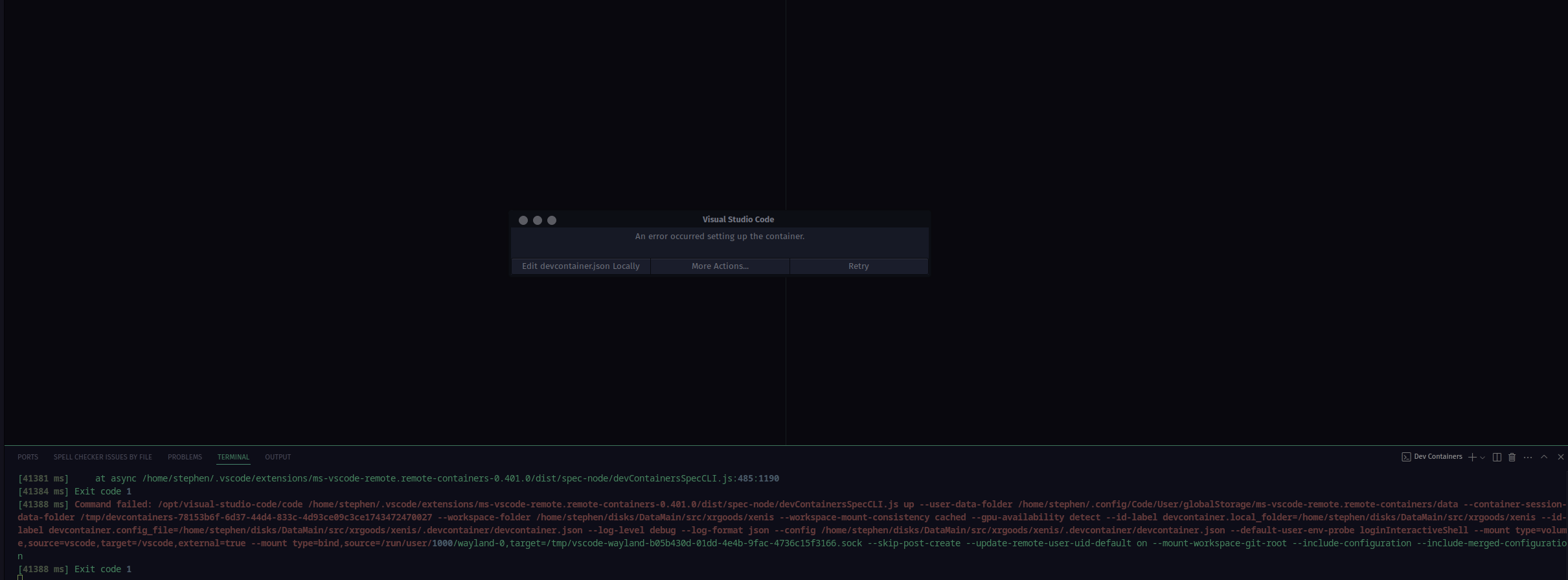

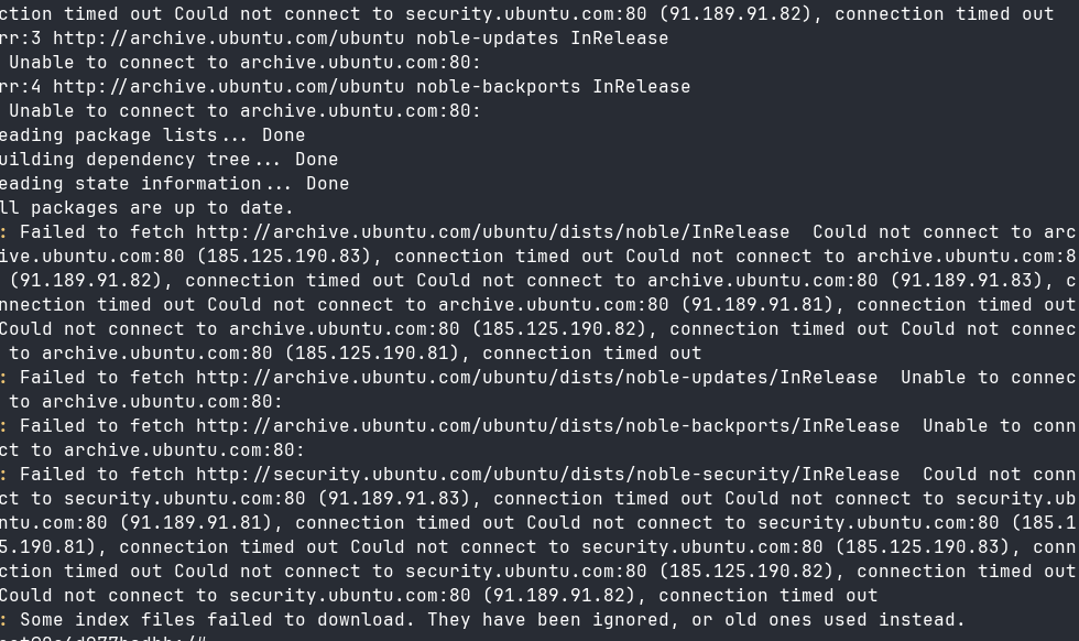

Installing platform package from https://github.com/vadimcn/codelldb/releases/download/v1.11.4/codelldb-linux-x64.vsix
Error: Error: connect ETIMEDOUT 140.82.112.4:443
warning: spurious network error (1 tries remaining): [28] Timeout was reached (Failed to resolve host 'index.crates.io' with timeout after 30011 ms)
error: failed to get `axum` as a dependency of package `lib-rpc-core v0.1.0 (/workspace/crates/libs/lib-rpc-core)`
Caused by:
download of ax/um/axum failed
Caused by:
failed to download from `https://index.crates.io/ax/um/axum`
Caused by:
[28] Timeout was reached (Failed to resolve host 'index.crates.io' with timeout after 30013 ms)
[Finished running. Exit status: 101]
ping google.com
^C
--- google.com ping statistics ---
23 packets transmitted, 0 received, 100% packet loss, time 25413ms
Docker seems to work if i don’t start vscode dev container at which point all internet access from docker stops working.
productVersion: { version: '1.98.2', date: '2025-03-12T13:32:45.399Z' }
[21:15:16] Installing the extension without checking dependencies and pack github.copilot-chat
[558447 ms] [21:15:16] Deleted existing extension from disk github.copilot-chat /home/vscode/.vscode-server/extensions/github.copilot-chat-0.25.1
[558584 ms] [21:15:16] Extracted extension to file:///home/vscode/.vscode-server/extensions/github.copilot-chat-0.25.1: github.copilot-chat
[558593 ms] [21:15:16] Renamed to /home/vscode/.vscode-server/extensions/github.copilot-chat-0.25.1
[558611 ms] [21:15:16] Extension installed successfully: github.copilot-chat file:///home/vscode/.vscode-server/extensions/extensions.json
[679977 ms] [21:17:17] #4: https://mobile.events.data.microsoft.com/OneCollector/1.0?cors=true&content-type=application/x-json-stream - error POST connect ETIMEDOUT 20.50.201.195:443
[684072 ms] [21:17:21] #13: https://marketplace.visualstudio.com/_apis/public/gallery/extensionquery - error POST connect ETIMEDOUT 13.107.42.18:443
[684073 ms] [21:17:21] #6: https://marketplace.visualstudio.com/_apis/public/gallery/extensionquery - error POST connect ETIMEDOUT 13.107.42.18:443
[684074 ms] [21:17:21] #10: https://mobile.events.data.microsoft.com/OneCollector/1.0?cors=true&content-type=application/x-json-stream - error POST connect ETIMEDOUT 20.50.201.195:443
[684074 ms] [21:17:21] #12: https://marketplace.visualstudio.com/_apis/public/gallery/extensionquery - error POST connect ETIMEDOUT 13.107.42.18:443
[684075 ms] [21:17:21] #11: https://marketplace.visualstudio.com/_apis/public/gallery/extensionquery - error POST connect ETIMEDOUT 13.107.42.18:443
[684075 ms] [21:17:21] #9: https://marketplace.visualstudio.com/_apis/public/gallery/extensionquery - error POST connect ETIMEDOUT 13.107.42.18:443
[684075 ms] [21:17:21] #8: https://marketplace.visualstudio.com/_apis/public/gallery/extensionquery - error POST connect ETIMEDOUT 13.107.42.18:443
[684076 ms] [21:17:21] #5: https://marketplace.visualstudio.com/_apis/public/gallery/extensionquery - error POST connect ETIMEDOUT 13.107.42.18:443
[684076 ms] [21:17:21] #7: https://marketplace.visualstudio.com/_apis/public/gallery/extensionquery - error POST connect ETIMEDOUT 13.107.42.18:443
[688168 ms] [21:17:25] #15: https://marketplace.visualstudio.com/_apis/public/gallery/extensionquery - error POST connect ETIMEDOUT 13.107.42.18:443
[688168 ms] [21:17:25] #14: https://marketplace.visualstudio.com/_apis/public/gallery/extensionquery - error POST connect ETIMEDOUT 13.107.42.18:443
[688169 ms] [21:17:25] #16: https://marketplace.visualstudio.com/_apis/public/gallery/extensionquery - error POST connect ETIMEDOUT 13.107.42.18:443
[692264 ms] [21:17:30] #17: https://marketplace.visualstudio.com/_apis/public/gallery/extensionquery - error POST connect ETIMEDOUT 13.107.42.18:443
[692265 ms] [21:17:30] #19: https://marketplace.visualstudio.com/_apis/public/gallery/extensionquery - error POST connect ETIMEDOUT 13.107.42.18:443
[21:17:30] #18: https://marketplace.visualstudio.com/_apis/public/gallery/extensionquery - error POST connect ETIMEDOUT 13.107.42.18:443
