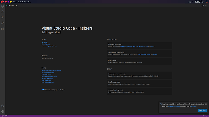

When Ever I try to use any Vs code I can not access the menu bar in the top panel .
Have Tried Reinstalling libdbusmenu-glib as specified on Arch Wiki But to no avail .
It is Still Not Working Kindly Assist me on the same .

On the login screen, change desktop seesion from wayland to plasma. (Xorg)
Wayland is a bit buggy right now.
Sorry for inconvenience.
Thanks a Lot !!
IT WORKED !!!
