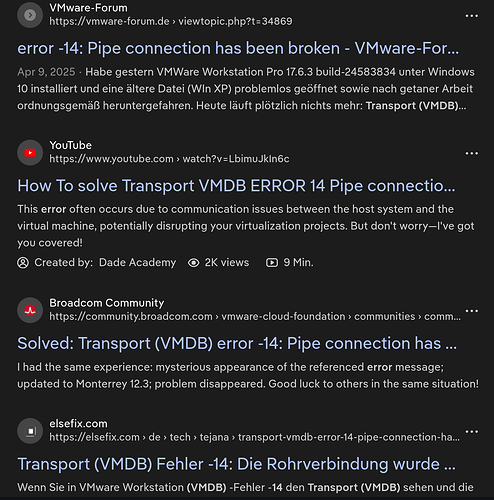

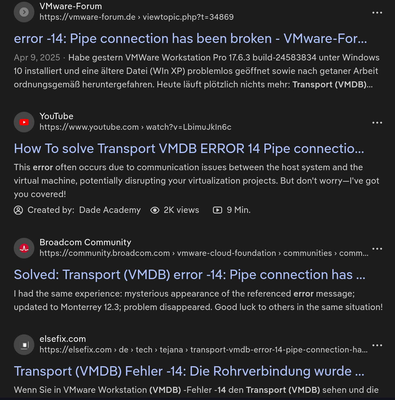

Did you search about the other errors in web?
